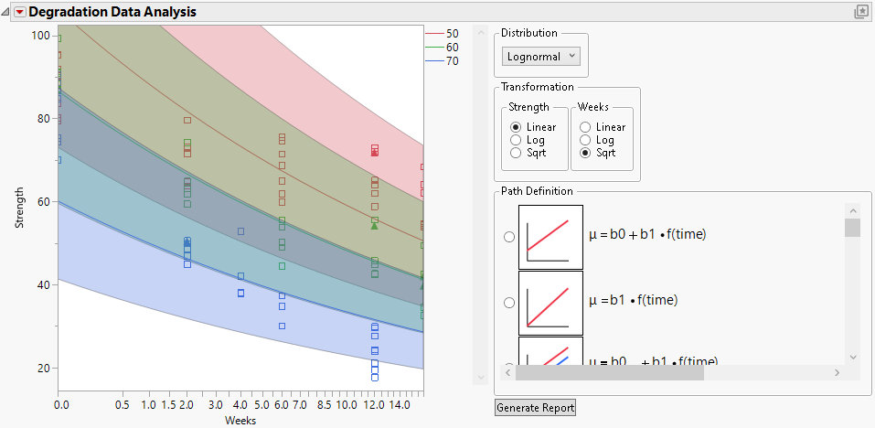

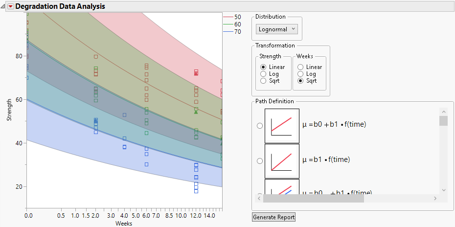

In this model, the location parameters are linear functions of transformed time with separate intercepts for the values of X but a common slope. Based on selections for Distribution and Transformation, the model fits might appear as curves. For example, selecting a Lognormal distribution gives the plot in Figure 9.12.
Figure 9.12 Common Slope Model Using a Lognormal Distribution

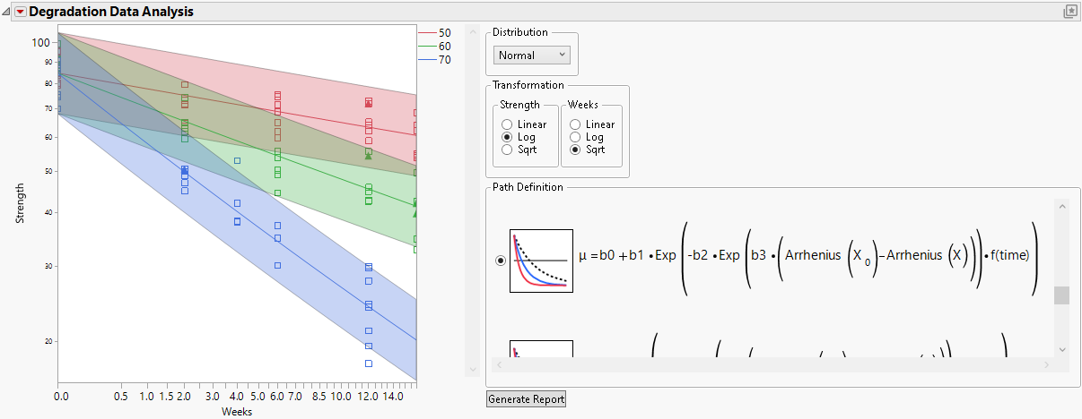

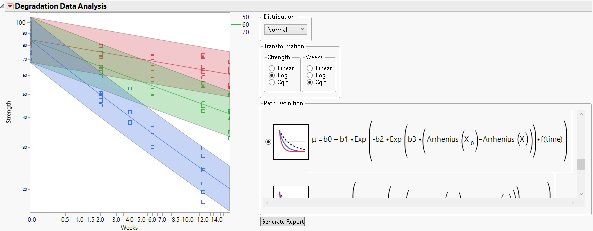

Given data exhibiting a negative slope over time, the fitted model can produce a plot similar to Figure 9.13. The figure is for Adhesive Bond.jmp. The selected temperature measurement scale is Celsius and the specified reference temperature under typical use conditions is 35 degrees.
Figure 9.13 Example of First-Order Kinetics Model Type 3
