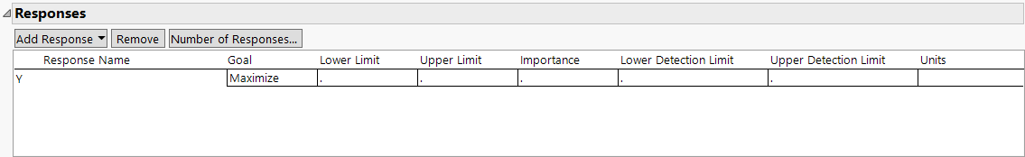

Figure 26.7 Responses Outline
Responses Outline
Add Response
Enters a single response with a goal type of Maximize, Match Target, Minimize, None, or Functional. If you select Match Target, enter limits for your target value. If you select Maximize or Minimize, entering limits is not required but can be useful if you intend to use desirability functions.

The Responses outline contains the following columns:
Response Name
The name of the response. When added, a response is given a default name of Y, Y2, and so on. To change this name, double-click it and enter the desired name.
Goal, Lower Limit, Upper Limit
The Goal tells JMP that you want to maximize or minimize your response, match a target, or that you have no goal for your response. JMP assigns a Response Limits column property, based on these specifications, to each response column in the design table. It uses this information to define a desirability function for each response. The Profiler and Contour Profiler use these desirability functions to find optimal factor settings. For further details, see Desirability Profiling and Optimization in Profilers and Response Limits.
– A Goal of Maximize indicates that the best value is the largest possible. If there are natural lower or upper bounds, you can specify these as the Lower Limit or Upper Limit.
– A Goal of Minimize indicates that the best value is the smallest possible. If there are natural lower or upper bounds, you can specify these as the Lower Limit or Upper Limit.
– A Goal of Match Target indicates that the best value is a specific target value. The default target value is assumed to be midway between the Lower Limit and Upper Limit.
– A Goal of None indicates that there is no goal in terms of optimization. No desirability function is constructed.
Note: If your target response is not midway between the Lower Limit and the Upper Limit, you can change the target after you generate your design table. In the data table, open the Column Info window for the response column (Cols > Column Info) and enter the desired target value.
Importance
When you have several responses, the Importance values that you specify are used to compute an overall desirability function. These values are treated as weights for the responses. If there is only one response, then specifying the Importance is unnecessary because it is set to 1 by default.
Image shown hereDetection Limits
The lower and upper detection limits are bounds beyond which the response cannot be measured. The detection limits are saved as a column property. You can use these limits to specify a censored response in either the Distribution or Generalized Regression platform. See Censoring in Fitting Linear Models.
Units
The experimental units for the factors. To insert Units, click and enter the appropriate units.
Editing the Responses Outline
In the Responses outline, note the following:
• Double-click a response to edit the response name.
• Click the goal to change it.
• Click on a limit or importance weight to change it.
• For multiple responses, you might want to enter values for the importance weights.
