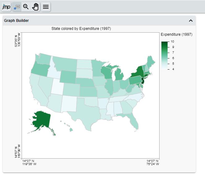

Figure 10.2 Web Page for Single Interactive HTML Report

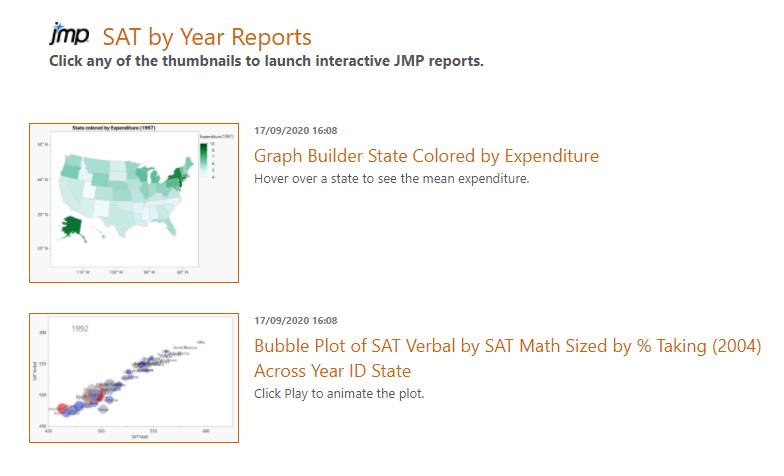

Figure 10.3 Index Page for Multiple Interactive HTML Reports
10. Click a thumbnail or report title to open a report.
