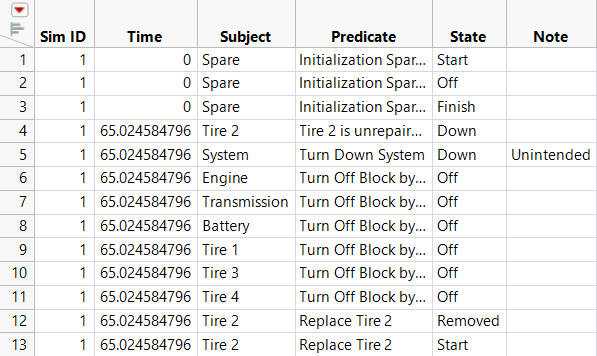

Simulation Results TableIn the Repairable Systems Simulation diagram, when you click the green arrow under Start to run the simulation, the results appear in a data table. This table describes the events and subsequent actions that occurred in each simulation iteration.
The results table contains the following columns:

Figure 13.10 RSS Results TableĀ
Notice that the first entry in Figure 13.10 is the start of the Initialization Spare in Trunk action, which has an immediate completion time. The action turns the Spare component off and then finishes while Time is still 0.
The next event that occurs is Tire 2 is Unrepairable when approximately 65 days have passed in the first simulation iteration. In row five, the system is unintentionally set to the Down state because only three tires are functional. The Need 4 Tires to Drive knot requires at least four tires, including the Spare, to be functional. The Tire 2 is Unrepairable event simultaneously triggers the Replace Tire 2 action and the Use Spare action. The Drive with Spare action is triggered in row eleven, and the system is set to the On state.
Notice that Tire 2 failed and was replaced by the Spare at the same time. No time elapsed between the time that the system was set to the Down state and the time that the system was returned to the On state. Because the subsequent actions had an immediate completion time, the Tire 2 is Unrepairable event did not cause any system outage time. The results explorer shows the system outage time that accumulates when actions are non-immediate.
