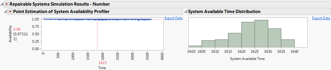

In the simulation results data table, when you run the Repairable Systems Simulation Results Explorer script, a report appears that contains an analysis of the simulation results.
Figure 13.11 Partial RSS Explorer Report
By default, the report contains two types of graphs. The first type of graph, shown on the left side of Figure 13.11, is a point estimate graph. The point estimate graph displays aggregated simulation results on the vertical axis plotted against simulation iteration time on the horizontal axis. The range of the horizontal axis is the duration that you specify in the simulation settings. The estimated probability of the system being available at a given time is shown in red next to the vertical axis. Below the point estimate is a 95% confidence interval for the point estimate.
Tip: To see the point estimation of system availability at a specific time in the simulation iteration, click the red number below the horizontal axis. Specify a time within the range of the simulation duration and press Enter.
The second type of graph, shown on the right side of Figure 13.11, is a histogram of the system available time from the simulation iterations. The bins in the histograms are representative of one of the following:
• Total simulation time.
• Proportion of the simulation duration.
Tip: Select the Export Data option beside a graph to create a data table with the data that the graph uses.
