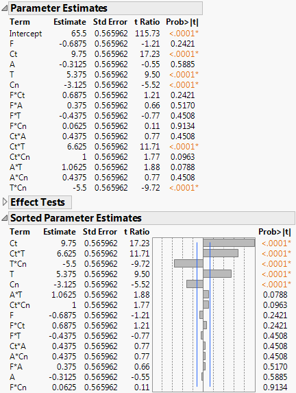

1. Select Help > Sample Data Folder and open Reactor.jmp.
3. Select Y and click Y.
4. Make sure that 2 appears in the Degree box near the bottom of the window.
5. Select F, Ct, A, T, and Cn and click Macros > Factorial to Degree.
6. Click Run.

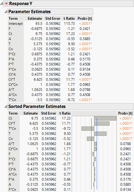

7. Click the Response Y red triangle and select Estimates > Sorted Estimates.
Figure 3.21 Sorted Parameter Estimates
The Sorted Parameter Estimates report also appears automatically if the Emphasis is set to Effect Screening and all of the effects have only one parameter.
Note the following differences between the Parameter Estimates report and the Sorted Parameter Estimates report (both shown in Figure 3.21):
• The Sorted Parameter Estimates report does not show the intercept.
• The effects are sorted by the absolute value of the t ratio, showing the most significant effects at the top.
• A bar chart shows the t ratio with vertical lines showing critical values for the 0.05 significance level.

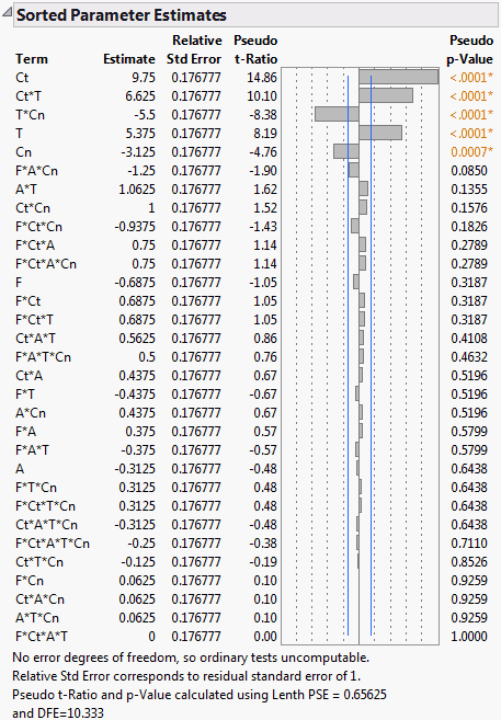

4. Select the following five columns: F, Ct, A, T, and Cn.
5. Click the Macros button and select Full Factorial.
6. Click Run.
Note that Lenth’s PSE and the degrees of freedom used are given at the bottom of the report. The report indicates that, based on their Pseudo p-Values, the effects Ct, Ct*T, T*Cn, T, and Cn are highly significant.
