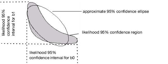

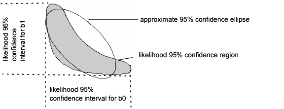

Figure 15.30 shows the contour of the goal SSE or negative likelihood, with the least squares (or least loss) solution inside the shaded region:
• The asymptotic standard errors produce confidence intervals that approximate the region with an ellipsoid and take the parameter values at the extremes (at the horizontal and vertical tangents).
• Profile confidence limits find the parameter values at the extremes of the true region, rather than the approximating ellipsoid.
Figure 15.30 Diagram of Confidence Limits for Parameters
Likelihood confidence intervals are more trustworthy than confidence intervals calculated from approximate standard errors. If a particular limit cannot be found, computations begin for the next limit. When you have difficulty obtaining convergence, try the following:
