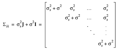

Then the covariance matrix is defined as follows:
Equation shown here
where J is a matrix consisting of 1s and I is an identity matrix.

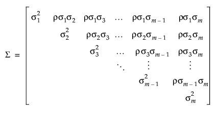

Here, ρ is the intra-class correlation coefficient and Equation shown here is the residual variance. Another option is to use the Compound Symmetry Unequal Variances structure in JMP, which allows the variance to vary across time points. This leads to the following covariance matrix:
Equation shown here

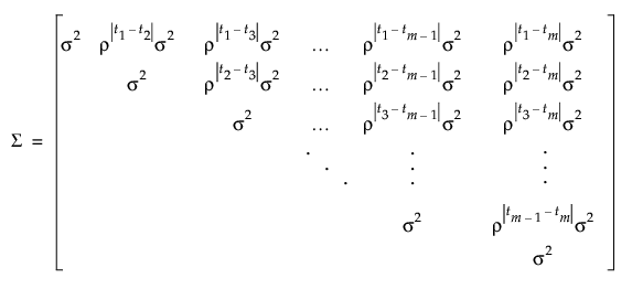

Equation shown here
Here tj is the time of observation j. In this structure, observations taken at any given time have the same variance, σ2. The parameter ρ, where -1 < ρ < 1, is the correlation between two observations that are one unit of time apart. As the time difference between observations increases, their covariance decreases because ρ is raised to a higher power. In many applications, AR(1) provides an adequate model of the within subject correlation, providing more power without sacrificing Type I error control.

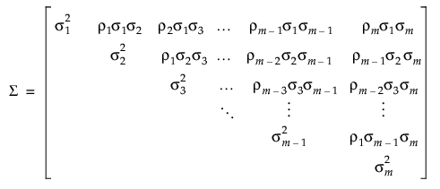

• Alternatively, the Toeplitz Unequal Variances structure allows the variance to vary across time points:
Equation shown here

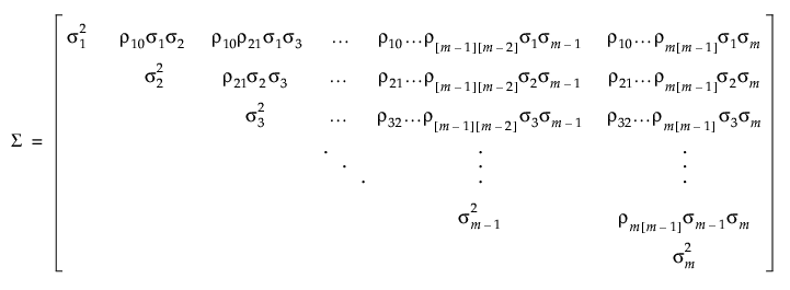

The antedependence model is a general model that is flexible and allows the correlation structure to change over time. In this model, the correlation between two observations at adjacent time points j - 1 and j is unique and is denoted ρj[j−1].
The correlation between pairs of observations at non-adjacent time points j and j′ is the product of all the adjacent correlations in between.
Equation shown here
For example, the correlation between the pair of observations at time points j=2 and j′=6 would be ρ21ρ32ρ43ρ54.

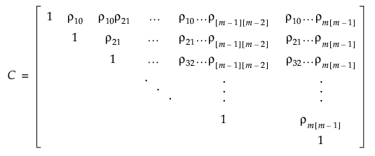

The correlation matrix is defined as follows:
Equation shown here
Two options in JMP use this correlation matrix:
• The Antedependent Equal Variance structure assumes equal variances across observation times while still allowing for the correlations to change. The variance among observations at any time is σ2 and the covariance matrix is Equation shown here.

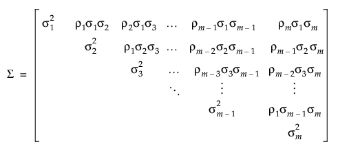

• The Antedependent structure allows the variance among observations at any given time to vary. Denote the variance among observations taken at time j is Equation shown here. Then the covariance matrix is defined as follows:
Equation shown here
