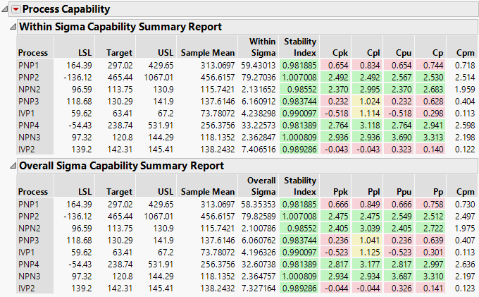

In the Process Capability red triangle menu, the Summary Report options show or hide a table that contains the following statistics for each variable: LSL, Target, USL, Sample Mean, various Sigma estimates, Stability Index, Cpk, Cpl, Cpu, Cp, Cpm, and Nonconformance statistics. If there is at least one nonmissing process importance value, an Importance column is also included in the Summary Report. These statistics are calculated using the sigma estimate specified in the report title. The columns for Stability Index, Cpk, Cpl, Cpu, and Cp are colored as green, yellow, and red to indicate adequate, marginal, and poor stability or capability. This color coding scheme matches what you would see in the Process Performance graph.

Figure 9.19 shows a subset of columns for both summary reports as described in Example of the Process Capability Platform with Normal Variables. The following optional columns are available for this report:

Note that the report (based on overall sigma) shows the overall capability indices Ppk, Ppl, Ppu, and Pp instead of the within capability indices Cpk, Cpl, Cpu, and Cp. The labeling of the overall capability indices depends on the setting of the AIAG (Ppk) Labeling preference.
Figure 9.19 Within Sigma and Overall Sigma Capability Summary Reports
