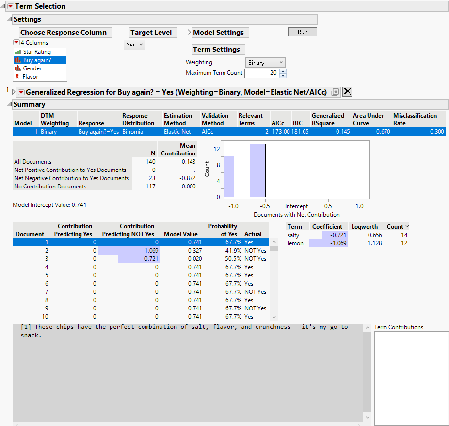

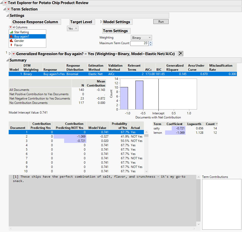

Image shown hereTerm Selection Report
After you run an analysis in the Text Explorer platform, the Term Selection report consists of three sections. The Settings report contains controls for specifying an analysis. See Term Selection Settings. Below the Settings report, there are initially closed Generalized Regression reports for each analysis that you have run. See Generalized Regression Models in Fitting Linear Models. The last section of the report is the Summary report.
Figure 12.12 Term Selection Report
Term Selection Summary Report
The Summary report contains a Model Comparison table, a Summary table and histogram, a Document Scores table, a Term Scores table, and a text box.
The Model Comparison table contains a row for each fitted model. The rest of the Summary report shows results from the currently selected model in this table.
The Summary table shows counts and mean scores for the documents, overall and by the predicted value of the response from the model. The Mean Contribution is the average of the contribution values in the Document Scores table. The Summary histogram shows the distribution of the overall contribution values of the documents. The histogram is interactive, so you can click on a bar to highlight the corresponding documents in the Document Scores table.
The Document Scores table shows the positive and negative contribution values for each document, as well as predicted and actual values for each document. For binomial response models, the predicted values are probabilities of the document being in the target level; for normal response models, the predicted values are the predictions from the fitted model for each document. If you select a row of the table, the text of the corresponding document appears in the text box below the table.
The Term Scores table lists each term that was selected by the fitted model, its coefficient from the model, its Logworth, and the count of occurrences of the term in the corpus. If you select a row of the table, the text of the corresponding document appears in the text box below the table.
The text box shows the text of documents that are selected in the Document Scores table or the context of terms that are selected in the Term Scores table.
