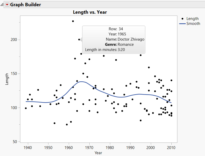

Figure 12.46 shows adding Genre, Name, and Length in minutes, reformatting the minutes, and formatting “Genre” in bold.
Figure 12.46 Customized Gridlet
Customized Gridlet
Example of Customizing a Gridlet
The following script creates the graph and hover label shown in Figure 12.46.

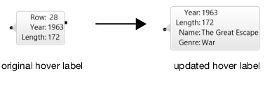

Example of Adding and Deleting Columns
This example describes how to use the Expunge command to remove the first entry added to the hover label when the underlying table has no Label columns, followed by two instances of the Annex command to add new rows. Note that you could have used a single Annex instance and passed to it a list of lists instead.
Figure 12.47 shows the original hover label and the updated hover label. Notice that Row was removed from the label. Name and Genre were added.
Figure 12.47 Example of the Expunge and Annex Commands
The following script creates the updated hover label shown in Figure 12.47.
