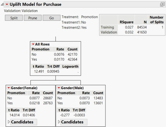

Image shown hereUplift Model
The uplift model is a type of partition model. The model graph represents the portion of observations in a model split on the vertical axis. The horizontal axis corresponds to observations, arranged by nodes. For each node, a black horizontal line shows the mean response. Within each split, there is a subsplit for treatment shown by a red or blue line. These lines indicate the mean responses for each of the two treatment groups within the split. The value ordering of the treatment column determines the placement order of these lines. As nodes are split, the graph updates to show the splits beneath the horizontal axis. Vertical lines divide the splits.
Beneath the graph are control buttons: Split, Prune, and Go. The Go button appears only if there is a validation set. Also shown is the name of the Treatment column and its two levels, called Treatment1 and Treatment2. If more than two levels are specified for the Treatment column, all levels except the first are treated as a single level and combined into Treatment2.
To the right of the Treatment column information is a report showing summary values relating to prediction. (Keep in mind that prediction is not the objective in uplift modeling.) The report updates as splitting occurs. If a validation set is used, values are shown for both the training and the validation sets.

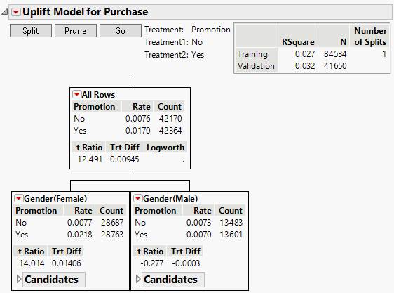

Image shown hereUplift Decision Tree
The decision tree shows a partition tree with the splits used to model uplift. See Figure 6.5 for an example using the Hair Care Product.jmp sample data table. Each node contains the following information:
Treatment
The name of the treatment column is shown, with its two levels.
Rate
(Appears only for two-level categorical responses.) For each treatment level, the proportion of subjects in this node who responded.
Mean
(Appears only for continuous responses.) For each treatment level, the mean response for subjects in this node.
Count
The number of subjects in this node in the specified treatment level.
t Ratio
The t ratio for the test for a difference in response across the levels of Treatment for subjects in this node. If the response is categorical, it is treated as continuous (values 0 and 1) for this test.
Trt Diff
The difference in response means across the levels of Treatment. This is the uplift, with the following assumptions:
– The first level in the treatment column’s value ordering represents the treatment.
– The response is defined so that larger values reflect greater impact.
Logworth
The value of the logworth for the subsequent split based on the given node.
Figure 6.5 Nodes for First Split
