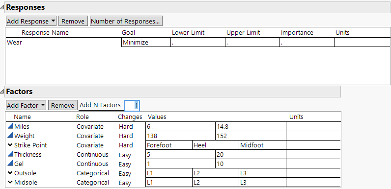

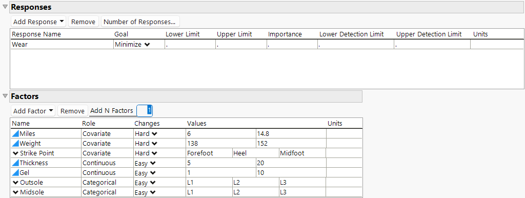

To add the remaining factors manually, follow step 8 through step 16. Or, to load factors from a saved table, select Load Factors from the Custom Design red triangle. Open the Runners Factors.jmp sample data table, located in the Design Experiment folder. If you select Load Factors, skip step 8 through step 16.
8. Type 2 next to Add N Factors.
9. Click Add Factor > Continuous.
10. Rename the two factors Thickness and Gel.
11. Change the Values for Thickness to 5 and 20.
12. Change the Values for Gel to 1 and 10.
13. Type 2 next to Add N Factors.
14. Click Add Factor > Categorical > 3 Level.
15. Rename the two factors Outsole and Midsole.
Keep the default Values for these factors.
Figure 5.61 Responses and Factors
16. Click Continue.

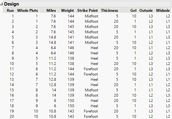

22. Click Make Design.
Figure 5.62 First 20 Runs of Design for Hard-to-Change Covariates
Of the 100 runners, 32 are selected based on their covariate values. The rows corresponding to the selected runners are selected in the RunnersCovariates.jmp sample data table. Settings of the experimental factors Thickness, Gel, Insole, and Outsole are determined so that the design is optimal for the model described in the Model section.

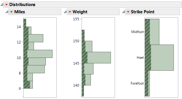

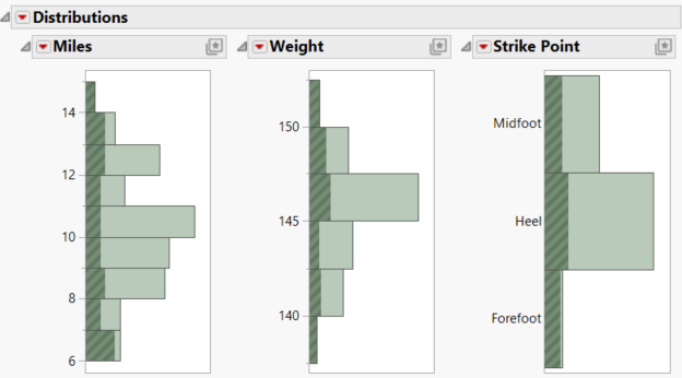

23. With the RunnersCovariates.jmp sample data table as the active table, select Analyze > Distribution.
24. Select all three columns as Y, Columns.
25. Check Histograms Only.
26. Click OK.
Figure 5.63 Histograms for 100 Runners with Selected Runner Data Shaded
The histograms illustrate how the design selected runners to balance runs across the covariates. The distribution of selected runners is similar to the overall distribution of all runners for each covariate.
