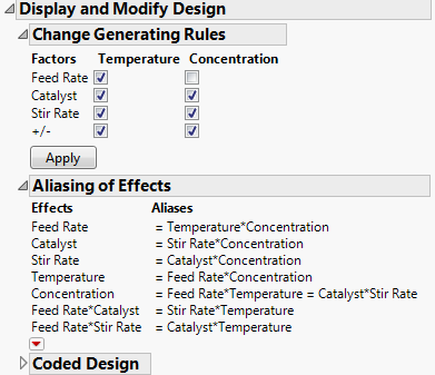

Figure 10.12 shows the default-generating rules for a 25-2 fractional factorial design (five factors and eight runs).
Figure 10.12 Generating Rules for the Standard 25-2 Design
In each column of the Change Generating Rules panel, the factor listed at the top and the factors in the column whose boxes are selected form a word in the defining relation. For example, the first column indicates that Temperature = Feed Rate*Catalyst*Stir Rate is a word in the defining relation.

Obtain the Defining Relations in the 25-2 Design
Figure 10.12 shows two columns of check boxes:
• The first column represents the word Temperature = Feed Rate*Catalyst*Stir Rate.
• The second column represents the word Concentration = Catalyst*Stir Rate.
Define I to represent a column consisting of the values +1. Because all factor levels are -1 or +1, the word in the first column is equivalent to Temperature*Feed Rate*Catalyst*Stir Rate = I. The word in the second column is equivalent to Concentration*Catalyst*Stir Rate = I. Together, these give the defining relations for the 25-2 design:
I = Temperature*Feed Rate*Catalyst*Stir Rate = Concentration*Catalyst*Stir Rate
Obtain the Aliasing of Effects Relations in the 25-2 Design
The aliasing structure in the Aliasing of Effects section is determined by the defining relations and the fact that factor levels are +1 and -1. Recall that the first generating rule is Temperature = Feed Rate*Catalyst*Stir Rate and the second is Concentration = Catalyst*Stir Rate.
To obtain the first relation in the Aliasing of Effects section, notice that applying these two generating rules gives the expression:
Temperature = Feed Rate*Catalyst*Stir Rate = Feed Rate*Concentration
– The second equality follows from replacing Catalyst*Stir Rate by Concentration using the second generating rule.
Now, post-multiply the first and third expressions by Concentration to obtain the following expression:
Temperature*Concentration = Feed Rate*Concentration*Concentration
Because the column for Concentration in the design matrix contains values of -1 and +1, the term Concentration*Concentration represents a column of +1 values. The expression becomes the first alias relation shown in the Aliasing of Effects section:
Temperature*Concentration = Feed Rate*I = Feed Rate
The other alias relations can be obtained using similar calculations.
