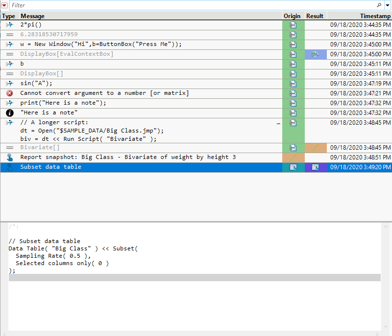

The Enhanced Log is a tabular view of the events in a JMP session. To view the JMP Log, select View > Log (Window > Log on macOS). By default, the log in JMP appears in Enhanced mode. The log window contains events, or actions, in the rows of the table and the corresponding JSL code and output in a separate text pane. This tabular view of the events is easy to navigate, displays errors and warnings, and can help you create a JSL script of the actions in a JMP session. For an example of using the log to generate a JSL script for recorded actions, see Example of Recording Actions in the Enhanced Log. Use the Workflow builder to capture the steps from the Enhanced Log in an easy to use workflow. See Workflow Builder.
Note: When you used the embedded log in a script window, the embedded log does not use the Enhanced Log mode. Further, any script output from a script window with an embedded log does not appear in the Enhanced Log.
Figure 4.8 Enhanced Log
Each row of the tabular view contains information in the following columns:
Type
Contains an icon that represents message type. For more information about the types of messages, see Filter.
Tip: You can hover over an icon in the Type column to see the type of message that a particular icon represents.
Message
Contains a description of the event or result. Among other things, this could be a recorded action, JSL that was submitted, the result of JSL that was submitted, or an error message. Each description of a logged item or result is limited to three lines of text; longer items are denoted with an Ellipsis icon
in the upper right corner of the Message section of the row. The full text for longer items appears in the text pane at the bottom of the log window.
Origin
Contains an icon that shows the type of JMP window from which the logged item or result was generated. If the Color by Window option is selected in the red triangle menu next to Filter, logged items generated by the same JMP window are specified by a common color. You can click on the icon in the Origin column to bring the corresponding window to the front.
Note: Not all rows in the log table have an icon in the Origin column.
Result
Contains an icon that shows the type of JMP window that contains the result. If the Color by Window option is selected, logged items generated by the same JMP window are specified by a common color. You can click on the icon in the Result column to bring the corresponding window to the front.
Note: Not all rows in the log table have an icon in the Result column.
Timestamp
Contains a date-time value that indicates when the logged item was generated.

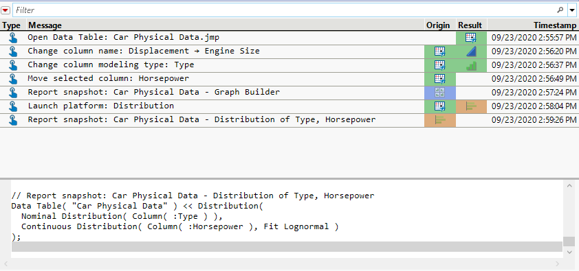

You can use the Enhanced Log to record many of the interactive actions that you perform for data cleanup and analysis. In this example, the Enhanced Log is used to generate a JSL script for some data manipulation and analysis actions.
1. Select View > Log.
2. Click the red triangle next to the Filter box and select Clear Log.
3. Select Help > Sample Data Folder and open Car Physical Data.jmp.
4. Right-click Displacement in the Columns panel in the data table, and select Column Info.
5. Type Engine Size for the Column Name. Click OK.
6. Right-click Type in the Columns panel in the data table, and select Column Info.
7. Select Ordinal for the Modeling Type. Click OK.
8. Click Horsepower in the Columns panel in the data table and drag it above Weight.
9. Select Graph > Graph Builder.
10. Drag Horsepower to the Y drop zone.
11. Drag Engine Size to the X drop zone.
12. Close the Graph Builder window.
13. Select Analyze > Distribution.
14. Select Type and Horsepower and click Y, Columns.
15. Click OK.
16. Click the red triangle next to Horsepower and select Continuous Fit > Fit Lognormal.
17. Close the Distribution window.
18. Select View > Log.
Figure 4.9 Enhanced Log
19. Press Ctrl and select the first, second, third, and last rows of the log table.
20. Click the red triangle next to the Filter box and select Save Script > To Script Window.
The script to reproduce the selected actions appears in a new script window. You can save this script to reuse later or use it as a starting point for a more complex analysis.
