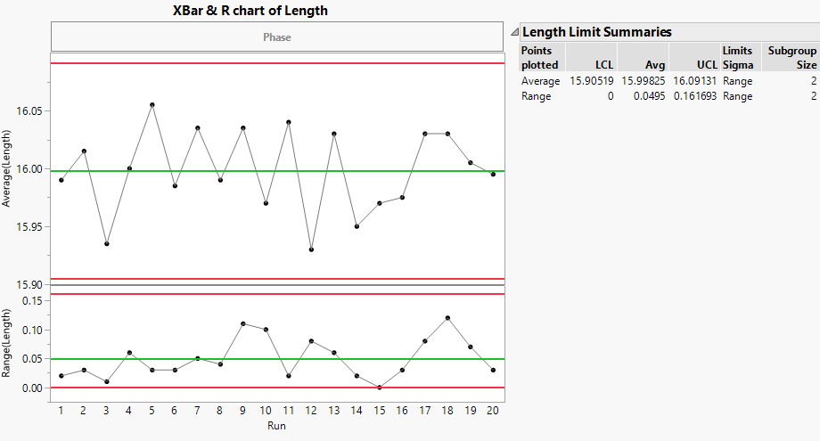

Create the Baseline Control Chart
First, examine whether the existing process is in control. If it is, we can use the control limits created by JMP as our baseline or historical limits.
1. Select Help > Sample Data Folder and open Quality Control/Line Length.jmp.
2. Select Analyze > Quality and Process > Control Chart Builder.
3. Drag Length to the Y zone.
An Individual and Moving Range chart of Length appears. This chart is appropriate if you have no natural subgrouping in your data. However, in this example, there is a natural subgrouping, which is each print run.
4. Drag Run to the Subgroup zone (at bottom).
Figure 3.10 XBar and R Chart of Line Length by Print Run
Three lines are drawn horizontally across the XBar and R charts. These are the calculated LCL (lower control limit), Avg (average) and UCL (upper control limit).
Ideally, we would like for all of our points to fall within the control limits, and we would like for the points to fall randomly within these limits. Looking at the graph, we see that no points fall outside of the control limits, and there does not appear to be a pattern to the points. To investigate further, perform Western Electric tests to check for patterns and trends that would cause these tests to fail. (The Western Electric tests are also referred to as Nelson tests.)
5. In the XBar chart, right-click and select Warnings > Tests > All Tests.
Notice that no points were circled or flagged. This means that our process is in control or stable.

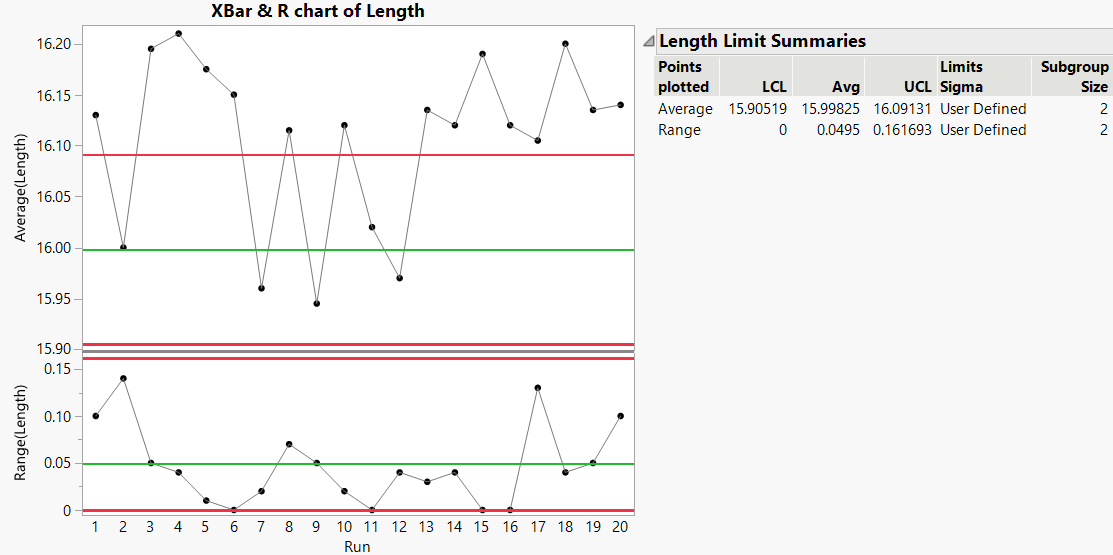

5. Right-click in the Average (XBar) chart and select Limits > Set Control Limits.
6. Enter these limits:
– LCL - 15.90519
– Avg - 15.99825
– UCL - 16.09131
These are the historical limits from the Average (XBar) chart in Figure 3.10.
7. Click OK.
8. Right-click in the Range (R) chart and select Limits > Set Control Limits.
9. Enter these limits:
– LCL - 0
– Avg - 0.0495
– UCL - 0.161693
These are the historical limits from the Range (R) chart in Figure 3.10.
10. Click OK.
Figure 3.11 XBar and R Chart of Line Length with Historical Limits
Rather than calculating limits from the data, JMP used the historical control limits that you defined. In the Length Limit Summaries table, notice that the Limits Sigma now says User Defined. Many points now fall outside of the limits. Also, the averages are higher than those of the baseline process. This process appears different from the original process that we used to calculate the baseline control limits.

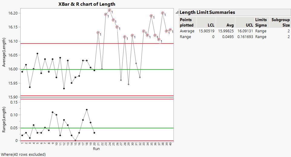

Another way to specify control limits is to exclude rows in a data table. One advantage to this method is that you can see both the historical data and new data in the same graph. This can help to visualize and investigate differences when they occur between the data collection periods.
To use this method, you must meet the following criteria:
• New and old data must reside in the same data table.
• Historical data and new data must all have equal subgroup sizes.
• All new data must be excluded in the data table (using Rows > Exclude/Unexclude).
In this example, new data have already been excluded.
1. Select Help > Sample Data Folder and open Quality Control/Combined.jmp.
This table contains old and new data, and the rows corresponding to the new data are excluded.
Figure 3.12 XBar and R Chart of Line Length with Excluded Data
JMP uses only the unexcluded rows (historical data) to create the control limits. The new data (excluded data) are plotted on the graph (dimmed), but these data were not used in any of the calculations. However, when you turn on the tests, all of the data is tested. The new data has many points that fall outside of the control limits and are flagged as failing Test 1 (point is more than 3σ from the average).

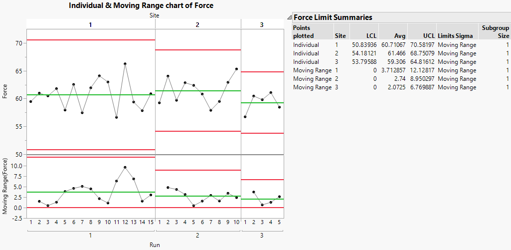

3. Drag Force to the Y zone.
5. Drag Site to the Phase zone.
Figure 3.13 Baseline Control Chart for Existing Data

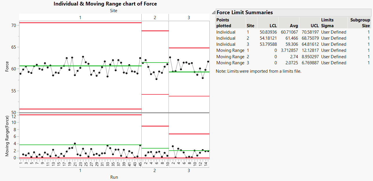

8. Click the Control Chart Builder red triangle and select Get Limits. Open the limits table that you saved in step 2.
This applies the historical limits to the new data in the Control Chart Builder report.
