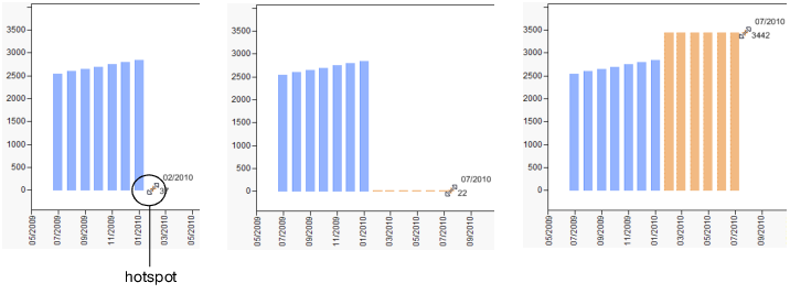

In the left graph, the blue bars represent previous production counts. To add anticipated production, follow these steps:
1. Drag a hotspot to the right to add one or more production periods.
The orange bars represent future production.
Figure 10.11 Add Production Periods

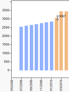

2. Drag each bar upward or downward to change the production count for each period.
Figure 10.12 Adjust Production Counts

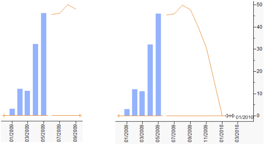

When you adjust production in the left graph, the right graph is updated to estimate future failures (Figure 10.13). Dragging a hotspot lets you change the forecast period. The orange line then shortens or lengthens to show the estimated failure counts.
Figure 10.13 Adjust the Forecast Period
