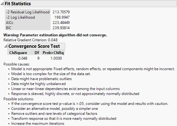

Image shown hereFit Statistics
The Fit Statistics report in the Mixed Model personality provides statistics used for model comparison. For all fit statistics, smaller is better. A likelihood ratio test between two models can be performed if one model is contained within the other. If not, a cautious comparison of likelihoods can be informative. For an example, see Fit a Spatial Structure Model.

-2 Residual Log Likelihood
The final evaluation of twice the negative residual log-likelihood, the objective function.
Equation shown here
where
Equation shown here
and p is the rank of X. Use the residual likelihood only for model comparisons where the fixed effects portion of the model is identical. See Likelihood, AICc, and BIC.
-2 Log Likelihood
The evaluation of twice the negative log-likelihood function. See Likelihood, AICc, and BIC.
Use the log-likelihood for model comparisons in which the fixed, random, and repeated effects differ in any of the models.
AICc
Corrected Akaike’s Information Criterion. See Likelihood, AICc, and BIC.
BIC
Bayesian Information Criterion. See Likelihood, AICc, and BIC.
Image shown hereConvergence Score Test
If there are problems with model convergence, a warning message is displayed below the fit statistics. Figure 8.11 shows the warning that suggests the cause and possible solutions to the convergence issue. It also includes a test of the relative gradient at the final iteration. If this test is non-significant, the model might be correct but not fully reaching the convergence criteria. In this case, consider using the model and results with caution. See Statistical Details for the Convergence Score Test.
Figure 8.11 Convergence Score Test
