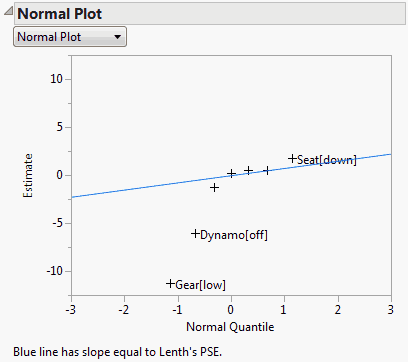

Figure 3.39 shows the Normal Plot report for the Bicycle.jmp sample data table. No transformation is needed for this model, so the plot shows the raw estimates plotted against their normal quantiles. A line with slope equal to Lenth’s PSE is shown on the plot. The plot suggests that Gear, Dynamo, and Seat are active factors.

6. Click the Response Y red triangle and select Effect Screening > Normal Plot.
The following Normal Plot appears.
Figure 3.39 Normal Plot
Normal Plot
