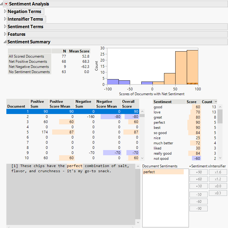

By default, the Sentiment Analysis report in the Text Explorer platform contains one open report: the Sentiment Summary report. The other reports are initially closed.
Figure 12.13 Sentiment Analysis Report

The Sentiment Summary report contains the results of the sentiment analysis based on the current settings. This report contains a Summary table and histogram, a Document Scores table, a Sentiment Terms table, a text box, and a control panel that enables you to add more sentiment and intensifier terms.
The Summary table shows counts and mean scores for the documents, broken down by how the documents were scored. The Mean Score is determined by the setting of the Scoring option. See Sentiment Analysis Report Options. The Summary histogram shows the distribution of the overall sentiment scores of the documents. The histogram is interactive, so you can click on a bar to highlight the corresponding documents in the Document Scores table.
The Document Scores table shows the positive and negative sentiment score sums and means, as well as the overall sentiment score for each document. If you select a row of the table, the text of the corresponding document appears in the text box below the table. If you specify a Score Column, the table contains the values from the scoring column.
Tip: You can hover over the cells in the Document Scores table to see the scoring calculations that were used to produce the table results.
The Sentiment Terms table lists each sentiment term, its score value, and the count of occurrences of the term in the corpus.
Tip: For sentiment terms with multiple words, you can hover over the cells in the Score column to see the calculations that were used to produce the score.
The text box shows the text of documents that are selected in the Document Scores table or the context of terms that are selected in the Sentiment Terms table. When you select a document in the Document Scores table, a list of the sentiments in that document appears to the right of the text box.
Tip: When you hover over a term in the text box that is classified as a negation, intensifier, or sentiment term, a box appears that shows the classification and contains a Remove button. Click the Remove button to quickly remove that term from the list of negation, intensifier, or sentiment terms.
The control panel activates when you select a term in the text box. To add a term as a sentiment term, select it in the text box and click one of the buttons below +Sentiment. To add a term as an intensifier term, select it in the text box and click one of the buttons below ×Intensifier.
