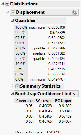

The Distribution platform provides summary statistics for your bootstrap results. It also produces a Bootstrap Confidence Limits report for any table that contains a BootID• column (Figure 11.6).
You can use the Distribution report to obtain two types of bootstrap confidence intervals:
• The Quantiles report provides percentile intervals. For example, to construct a 95% confidence interval using the percentile method, use the 2.5% and 97.5% quantiles as the interval bounds.
• The Bootstrap Confidence Limits report provides bias-corrected percentile intervals. The report shows intervals with 95%, 90%, 80%, and 50% coverage levels. The BC Lower and BC Upper columns show the lower and upper endpoints, respectively. For more information about the computation of the bias-corrected percentile intervals, see Statistical Details for the Bias-Corrected Percentile Intervals.
Figure 11.6 Bootstrap Confidence Limits Report
The Original Estimate at the bottom of the Bootstrap Confidence Limits report is the estimate of the statistic using the original data.
For more information about interpreting the Bootstrap Confidence Limits report, see Overview of the Bootstrapping Feature. Efron (1981) describes the methods for both the percentile interval and the bias-corrected percentile interval.
