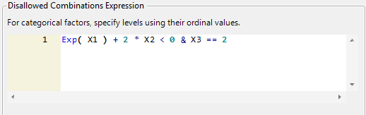

Use this option to disallow particular combinations of factor levels using a JSL script. This option can be used with continuous factors or mixed continuous and categorical factors.
This option opens a script window where you insert a script that identifies the combinations that you want to disallow. The script must evaluate as a Boolean expression. When the expression evaluates as true, the specified combination is disallowed.
When forming the expression for a categorical factor, use the ordinal value of the level or the name of the level. If a factor’s levels are high, medium, and low, specified in that order in the Factors outline, their associated ordinal values are 1, 2, and 3. For example, suppose that you have two continuous factors, X1 and X2, and a categorical factor X3 with three levels: L1, L2, and L3, in order. You want to disallow levels where the following is true:
Enter the expression (Exp(X1) + 2*X2 < 0) & (X3 == 2) into the script window.
Figure 22.7 Expression in Script Editor
(In the figure, unnecessary parentheses were removed by parsing.) Notice that functions can be entered as part of the Boolean expression. The expression (Exp(X1) + 2*X2 < 0) & (X3 == “L2”) is also valid.
