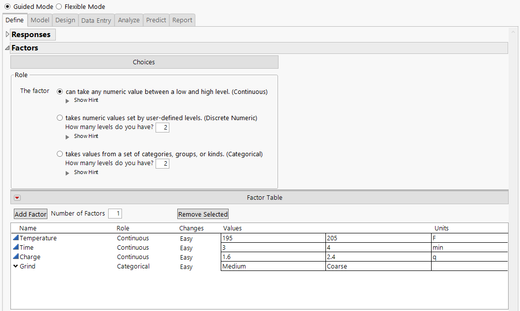

You add the factors by factor role.
1. Click the radio button for “can take any numeric value between a low and high level. (Continuous)”.
2. Set the Number of Factors to 3.
3. Click Add Factor.
4. Click the radio button for “takes values from a set of categories, groups, or kinds. (Categorical).
5. Set “How many levels do you have?” to 2.
6. Set the Number of Factors to 1.
7. Click Add Factor.
The next steps are completed within the Factor Table. Use Table 7.1 to guide your entries.
8. Double click on X1 and type Temperature. Set the values to 195 and 205, and set the units to F.
9. Double click on X2 type Time. Set the Values to 3 and 4, and set the units to min.
10. Double click on X3 type Charge. Set the Values to 1.6 and 2.4, and set the units to q.
11. Double click on X4, type Grind, set the Values to Coarse and Medium.
Figure 7.2 Completed Factor Table on the Easy DOE Define Tab

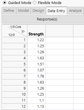

Data Entry
After you have run your experiment and collected data, navigate to the Data Entry tab. Enter the results of the experiment as shown below.
Figure 7.3 Strength Results
Strength Results

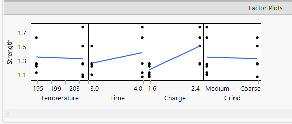

As you enter data, the Factor Plots update to show the response versus each factor. The Factor Plot shows the data points with a line connecting the mean response at each factor level. Use the plots as an initial view of which factors have the largest impact on your response. For this example, observe that Charge has the biggest impact on the Strength.
Note: Easy DOE randomizes the run order for each design. Using the ordering of the responses in Figure 7.3, your results might differ from those shown in Figure 7.4, Figure 7.5, and Figure 7.7.
Figure 7.4 Factor Plots
Factor Plots

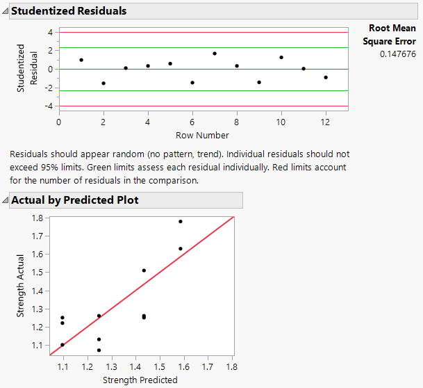

Use the Studentized Residuals plot to evaluate the model fit. All residuals fall within the green limits. The residuals do not show a pattern. You can conclude the model is reasonable. Use the Actual by Predicted plot as a second check on your model fit. The data points fall along the red Y = X line, indicating that the model predictions are reasonable.
Figure 7.6 Residuals and Actual by Predicted Plots

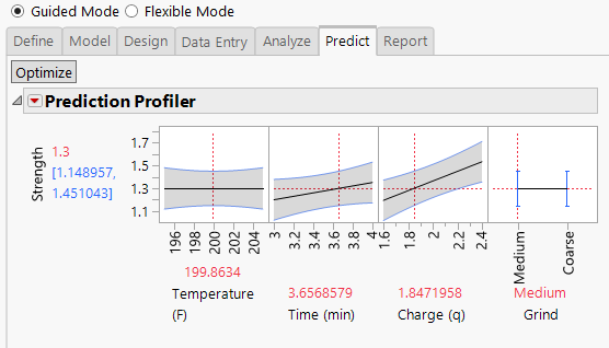

Predict
Navigate to the Predict tab and click Optimize. One optimal setting has Time at 3.65 minutes and Charge to 1.85q to optimizes the strength at 1.3. There are multiple settings of Time and Charge that result in a strength of 1.3. Your results may show an alternative optimal solution.
Figure 7.7 Prediction Profiler on Predict Tab
