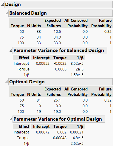

The Design report provides a balanced and an optimal design with parameter variance covariance matrices for the parameters. You can compare the parameter variance estimates of the two designs and see that the biggest difference is in the estimation of 1/β. The primary difference between the designs is that the optimal design requires only two Torque settings.
The optimal design is computed based on the levels of the test runs, the total number of units to be tested, and the prior information that you specified. The optimal design consists of testing the specified number of units at each torque level:
– 82 units at 50 Nm
– 0 units at 75 Nm
– 18 units at 100 Nm

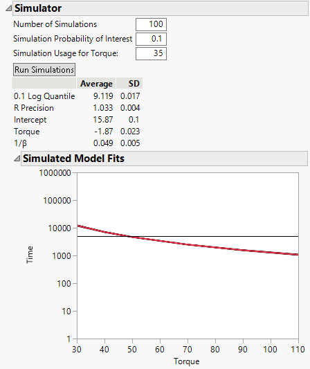

Evaluate the proposed ALT design with the simulator. Use the simulator to simulate the results of your test plan based on the assumptions used to build the design. This is a way to evaluate if the test plan is sufficient before running the test plan.
1. Enter 100 for the Number of Simulations.
2. Enter 0.1 for the Simulation Probability of Interest.
3. Enter 35 for the Simulation Usage for Torque.
4. Click Run Simulations to run 100 simulations of the experiment. This is to check to see whether the 100 units that you plan to test are sufficient given your prior assumptions for the design.
Figure 23.14 Simulation Results
Simulation Results
The simulated model fits shows that the 100 simulations of the model are all similar as they all fall close to the average shown by the red curve. The Y axis is on a log scale.
5. Use the magnifier tool to view the fits around the 35 normal usage condition. If helpful, change the Y-axis scale from log to linear. Double-click the Y axis and select Linear from the Type menu and click OK.
You expect variability in your estimated of the normal usage condition. The simulation helps you evaluate if your ALT plan is acceptable. If there is too much variability, you might need to increase the number of units on test or adjust the test conditions.
