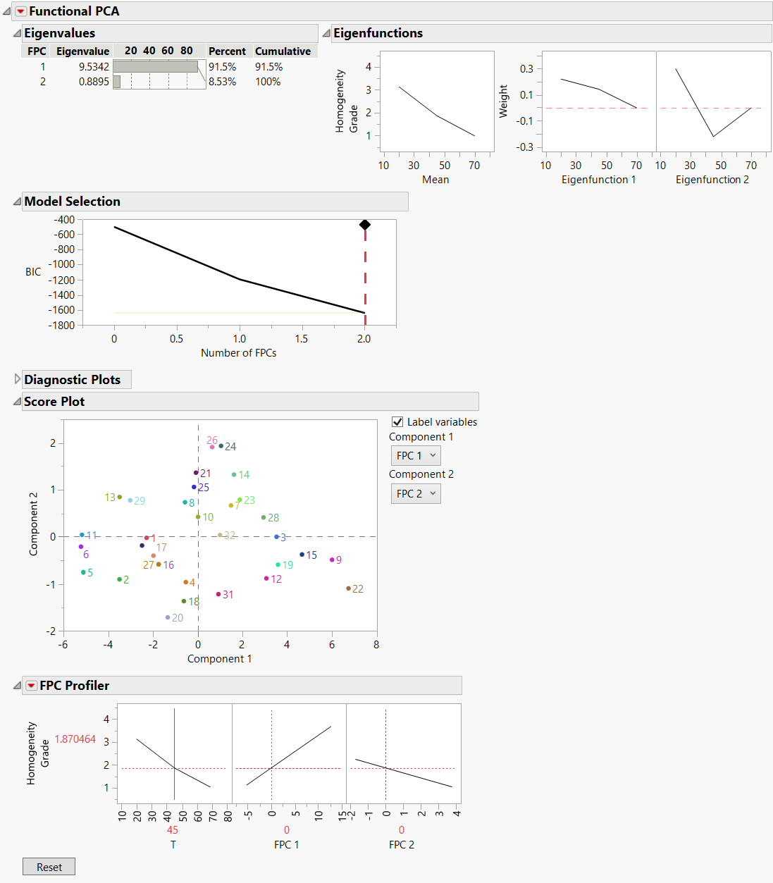

8. Click the Functional Data Explorer red triangle and select Models > B-Splines.
The best fitting model is a linear spline model with one knot.

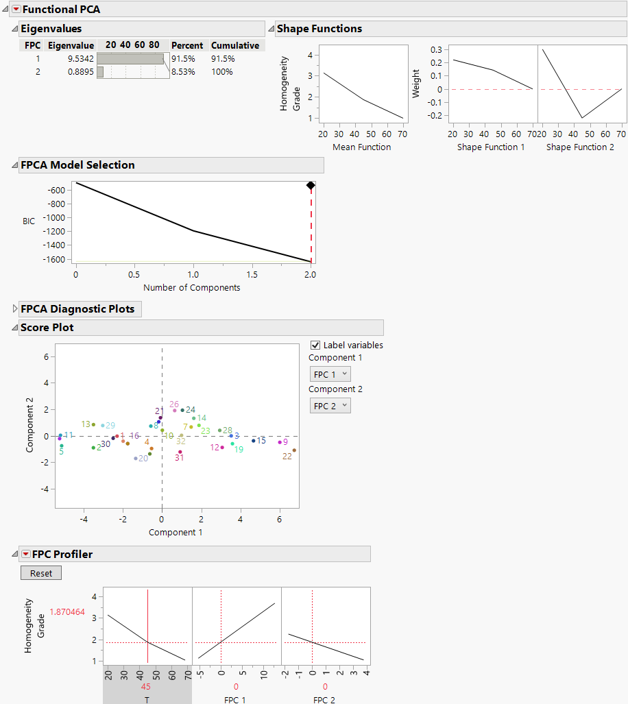

Figure 16.10 Functional PCA for Homogeneity GradeĀ
The Functional PCA report shows that two functional principal components are needed to explain the variability in the data. The FPC Profiler shows how Homogeneity Grade is affected by the FPCs across the different temperatures. However, there is no way to tell how the actual ingredients affect the Homogeneity Grade.

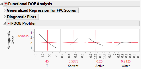

Figure 16.11 FDOE Profiler for Homogeneity GradeĀ
The FDOE Profiler enables you to explore how Homogeneity Grade changes based on the predictors you are actually interested in. In general, Homogeneity Grade seems to decrease as the amount of Active increases.
Note: In this example, the values of Active, Solvent, and Water are constrained to sum to 1. This constraint is reflected in the profiler.
