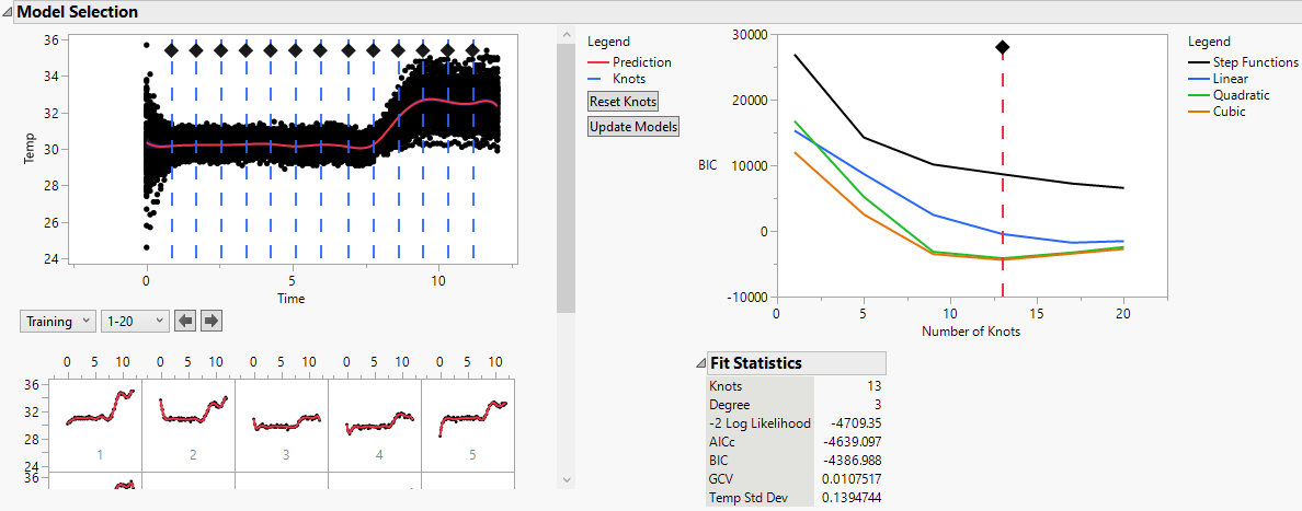

Figure 16.1 B-Spline Model Selection in FDE
