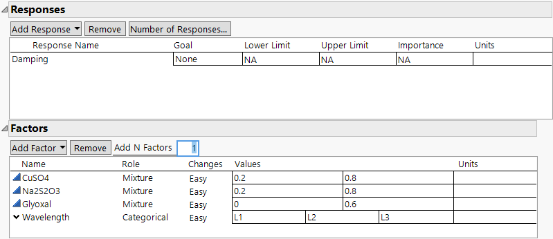

1. Select DOE > Custom Design.
2. Double-click Y under Response Name and type Damping.
3. Click Maximize under Goal and change it to None.
The goal is set to None because the authors of the study do not mention how much damping is desirable.Select Help > Sample Data Folder and open Design Experiment/Donev Mixture Factors.jmp.
4. Click the Custom Design red triangle and select Load Factors.
This loads the three mixture ingredients and the categorical environmental factor. Note that the bounds on the values of the three mixture factors are also loaded.
Figure 5.48 Responses and Factors

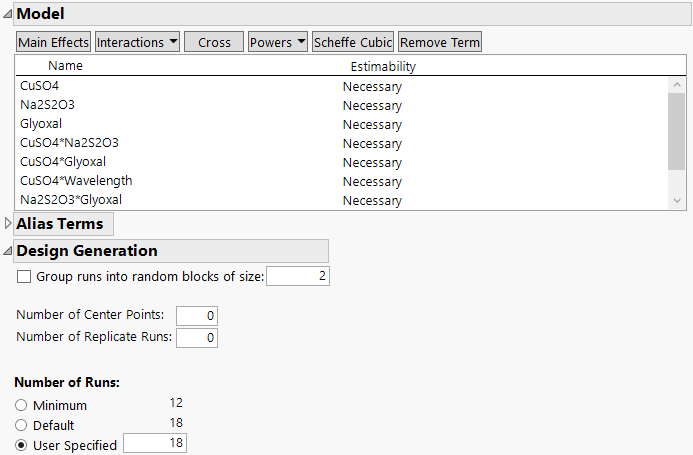

5. In the Model section, click Interactions > 2nd.
An informational JMP Alert window reminds you that JMP removes the main effect terms for non-mixture factors that interact with all the mixture factors. This means that the main effect of Wavelength is removed, but all two-way interactions of mixture factors with Wavelength are added.
6. Click OK to dismiss the message.
The effects in the Model section define a response surface model in the mixture ingredients along with the additive effect of the wavelength. See Scheffé (1958).
Figure 5.49 Model and Design Generation
7. Leave the number of runs at 18.
The choice of 18 runs allows six runs for each of the three levels of the wavelength factor.

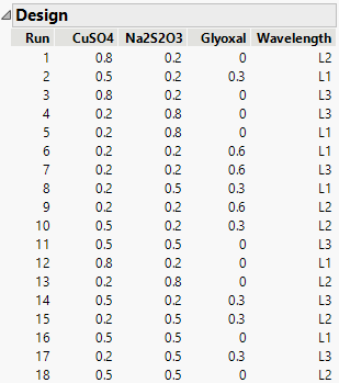

10. Click Make Design.
Figure 5.50 18-Run Design
18-Run Design
You can check that there are six runs for each level of Wavelength.

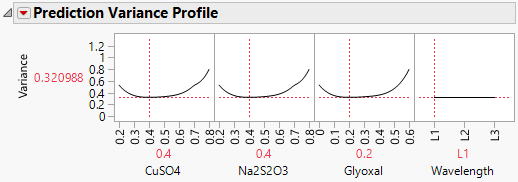

1. Open the Design Evaluation > Prediction Variance Profile section.
Figure 5.51 Prediction Variance Profile for 18-Run Design
Move the slider for Wavelength to verify that the relative prediction variance profiles for the mixture factors do not change across the levels of Wavelength. Move the slider for any one of the mixture factors. The sliders for the other two mixture factors adjust to make the mixture ingredients sum to one. Notice that the smallest relative prediction variances occur near the center settings for the mixture factors.
2. Click the Prediction Variance Profile red triangle and select Maximize Variance.
Notice that the maximum relative prediction variance over the design space is 0.8 times the error variance.

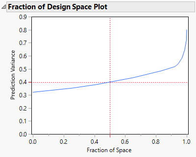

3. Open the Fraction of Design Space Plot section.
Figure 5.52 Fraction of Design Space Plot for 18-Run Design
Over the entire design space, the relative prediction variance is below 0.8. The minimum relative prediction variance is about 0.32. As seen in Figure 5.51, the minimum occurs near the center settings for the mixture factors.
