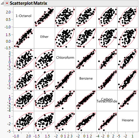

In the Multivariate platform, the Scatterplot Matrix report helps you visualize the correlations between each pair of response variables.
Figure 3.4 Scatterplot Matrix
Scatterplot Matrix
Turn on the Density Ellipses option to show a 95% bivariate normal density ellipse in each scatterplot. Assuming that each pair of variables has a bivariate normal distribution, this ellipse encloses approximately 95% of the points. The narrowness of the ellipse reflects the degree of correlation of the variables. If the ellipse is fairly round and is not diagonally oriented, the variables are uncorrelated. If the ellipse is narrow and diagonally oriented, the variables are correlated.
Tips:
• Re-sizing any cell resizes all the cells.
• Drag a label cell to another label cell to reorder the matrix.
• When you look for patterns in the scatterplot matrix, you can see the variables cluster into groups based on their correlations. Figure 3.4 shows two clusters of correlations: the first two variables (top, left), and the next four (bottom, right).
