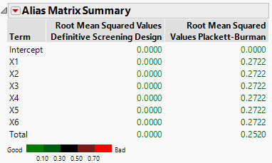

Figure 17.18 Alias Matrix Summary for Two Designs
Figure 17.18 shows the Alias Matrix Summary report for the Plackett-Burman and Definitive Screening designs constructed in Example of Comparing Designs, with only main effects in the Model section. All two-factor interactions are in the Alias Terms list. The table shows that, for the Definitive Screening Design, main effects are uncorrelated with two-factor interactions.

For example, to obtain the Alias Matrix Summary entry in Figure 17.18 corresponding to X1, square the terms in the row for X1 in the Alias Matrix, average these, and take the square root. You obtain 0.2722.
