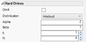

• For K out of N components, you must also enter K, the minimum number of components that must function for the system to function, and N, the total number of components in the shape.
• For Knot components, enter the Minimum Available Dependences. The Knot shape enables you to configure a k-out-of-n shape where the shapes that are joined have different distributions. The Minimum Number of Dependencies is k, the minimum number of paths leading to the Knot that need to function in order for the system to function.
Figure 12.14 Example of a Weibull Configuration for a K out of N Shape
