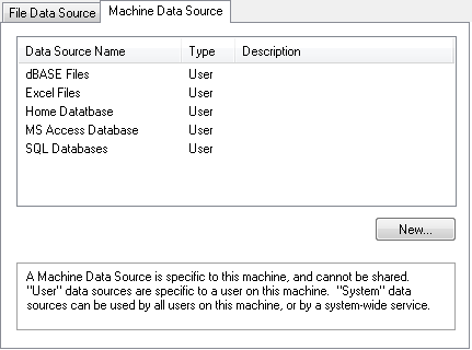

3. (Windows) In the Select Data Source window (Figure 3.54), click the Machine Data Source tab, select the data source, click OK, enter the user name and password, and then click OK.
(macOS) In the Choose DSN window, select the data source, enter the user name and password, and then click Choose DSN.

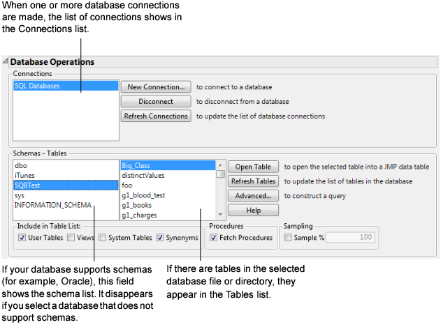

The Database Open Table window appears (Figure 3.55).
2. If you are already connected to the database, select it in the Connections box. Follow the steps in Connect to a Database With Open Table.
The Connections box lists data sources to which JMP is connected. The Schemas - Tables box lists schemas for those databases that support them.

3. If the desired data source is not listed in the Connections box, click New Connection to choose a data source. The method of choosing a data source depends on your operating system.
4. Select the desired data source in the Connections box. The tables list in the Tables box updates accordingly. The update might take a several seconds, depending on the number of tables and the speed of the connection to the database. If your database supports schemas, tables are loaded for the first schema in the list, and on other schemas as you click them.
5. Control which tables are listed by choosing the options in the Include in Table List group of check boxes.

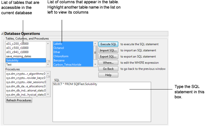

3. From the Database Open Table window, click the Advanced button to open specific subsets of a table.
4. Either type in a valid SQL statement, or modify the default statement. Figure 3.56 shows a default SQL Select statement appropriate for the selected file. See Structured Query Language (SQL): A Reference, for a description of SQL statements that you can use.
Instead, you can add expressions by clicking the Where button and using the WHERE Clause editor to create expressions. See Use the WHERE Clause Editor.
Figure 3.56 Reading All Variables from the Solubility Table Stored in an Excel File
5. Click Execute SQL. A JMP data table appears with the columns that you selected. See “Use Data Table Variables”.
