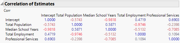

Figure 3.25 Correlation of Estimates Report
The Correlation of Estimates report in Figure 3.25 shows high negative correlations between the parameter estimates for the Intercept and Median School Years (–0.9818). High negative correlations also exist between Total Population and Total Employment (–0.9746).
