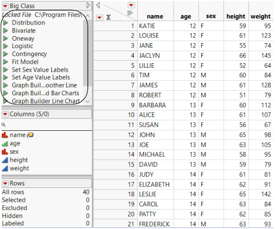

To automatically complete various analyses and tasks, you can create a JSL script and save it to the data table (Figure 4.63). For more information about writing data table scripts, see “Table Scripts” in the Scripting Guide.
Figure 4.63 Scripts Saved With the Data Table

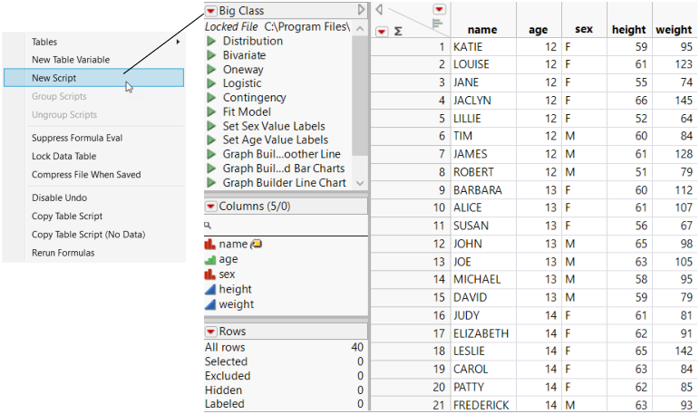

Write a JSL Script for the Data Table
To add a script to a data table using JSL
1. Click the red triangle to the left of the data table name in the Table panel.
Figure 4.64 Creating a Script
Creating a Script
2. Select New Script.
3. Give the script a name by typing it into the box beside Name.
4. Add the script by entering JSL code into the box beside Script.
5. Perform one of the following actions:
– If you want to run the JSL Debugger on the script to check it for errors, click Debug Script.
– If you are finished editing the script, click OK. The script appears in the Table panel and the window closes.
– If you are not finished editing the script and want to save it, click Save. The script appears in the Table panel and the window remains open for further editing.
– If you want to run the script, click Run.
