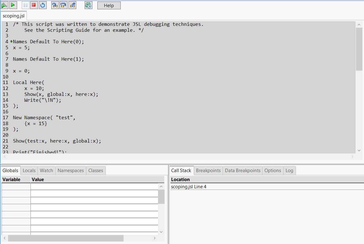

The Debugger opens in a new instance of JMP (Figure 4.11). The original instance is inoperable until the script produces something that requires interaction. At that point, the Debugger window becomes inoperable until you perform whatever action is required. Then control is returned to the Debugger. Close the Debugger to work again in the original instance of JMP.
Figure 4.11 The Debugger Window
The Debugger Window
Use the buttons at the top to control the Debugger or the JSL Profiler. One or more scripts that you are debugging or profiling are shown in tabs. If your script includes other scripts, each one opens in a new tab.
Tabs in the bottom portion of the Debugger provide options to view variables, namespaces, the log, and the current execution point; work with breakpoints; and set options.
Tip: To view or edit long values on a tab in the Debugger, right-click the value and select Edit. The code opens in a script editor.

The call stack lists the current execution point in scripts and functions. The main script is always the first script listed. If you call a function, the function is added on top of the calling script. Likewise, any included files are added to the top of the list as you step through them. When you exit any function or script, it is removed from the list and you return to the next one in the list. The current line numbers are updated as you step through.
Double-click a row in the call stack to move the cursor to the specified line.
Breakpoints
Add, edit, delete, and disable or enable breakpoints on lines. See Work with Breakpoints. You can also double-click a row on the Breakpoints tab to move the cursor to the specified line.
