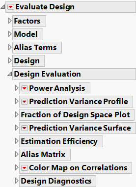

The Evaluate Design report consists of two parts:
• The Factors, Model, Alias Terms, and Design sections define the model and design.
• The Design Evaluation section provides results that describe the properties of your design.
This section pertains to the model and design portion of the report. For information about the design evaluation section, seeDesign Evaluation Report.
Figure 16.4 Evaluate Design Window Showing All Possible Sections
Your selections in the launch window and the design table populate the Factors, Model, Alias Terms, and Design sections of the report. However, you can modify the effects in the Model and Alias Terms sections. The Design Evaluation sections update as you make changes.
The Evaluate Design report has four initial sections.
• Factors
• Model
• Alias Terms
• Design
