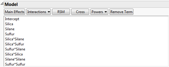

In the Evaluate Design report, the initial entries in the Model section depend on whether the associated data table contains a Model or Fit Model script:
• If there is a script, the Model section contains the estimable effects specified in the script. Effects are entered into the model in the order specified in the script. If the model script contains more effects than are estimable, those that are not estimable are not included in the model for evaluation.
• If there is no script, the Model section contains only main effects.
Figure 16.6 Model for Bounce Data.jmp
You can add effects to the model using the buttons in the Model section of the report:
Main Effects
Adds main effects for all factors in the model.
Interactions
Adds interaction effects. If no factors are selected in the Factors section, select 2nd, 3rd, 4th, or 5th to add all appropriate interactions up to that order. Add interactions up to a given order for specific factors by selecting the factor names in the Factors section, selecting Interactions, and then specifying the appropriate order. Interactions between non-mixture and mixture factors, and interactions with blocking and constant factors, are not added.
RSM
Adds interaction and quadratic terms up to the second order (response surface model terms) for continuous factors. Categorical factors are not included in RSM terms. Main effects for non-mixture factors that interact with all the mixture factors are removed.
Cross
Adds specific interaction terms. Select factor names in the Factors section and effect names in the Model section. Click Cross to add the crossed terms to the Model section.
Powers
Adds polynomial terms. If no factor names are selected in the Factors section, adds polynomial terms for all continuous factors. If factor names are selected in the Factors section, adds polynomial terms for only those factors. Select 2nd, 3rd, 4th, or 5th to add polynomial terms of that order.
Scheffé Cubic
(Available only for designs with mixture factors.) Adds Scheffé cubic terms for all mixture factors. These terms are used to specify a mixture model with third-degree polynomial terms.
Remove Term
Removes selected effects.
