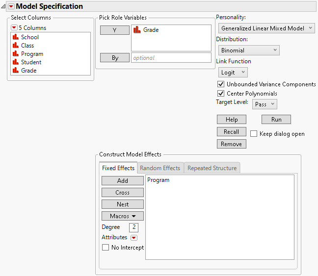

5. Select Program and click Add on the Fixed Effects tab.
Figure 9.2 Completed Fit Model Launch Window Showing Fixed Effects

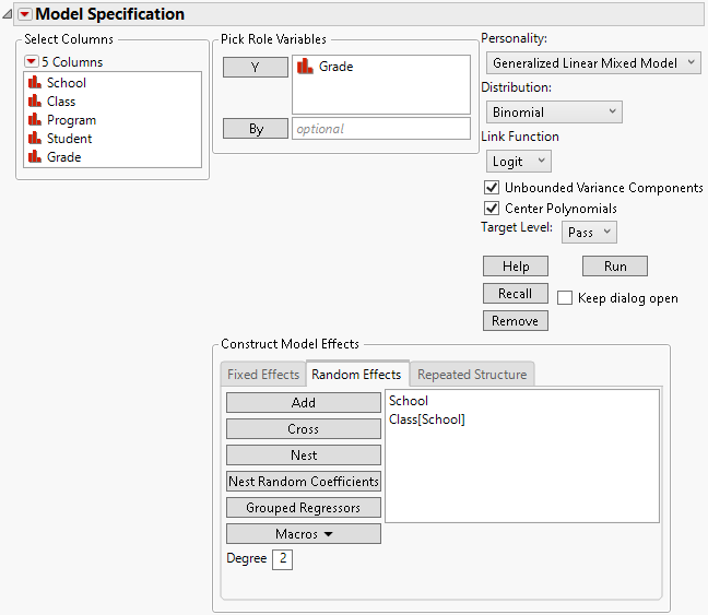

7. Select School and Class and click Add.
8. Select School from the Select Columns list, select Class from the Random Effects tab, and then click Nest.
Figure 9.3 Completed Fit Model Launch Window Showing Random Effects Tab

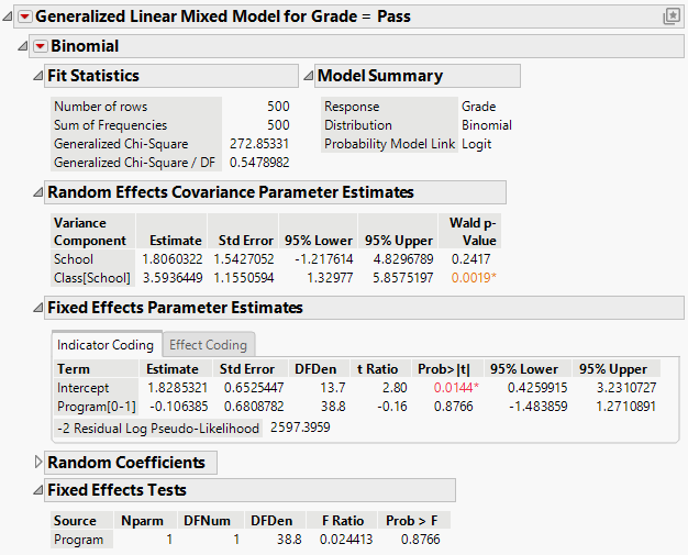

9. Click Run.
The Generalized Linear Mixed Model report is shown in Figure 9.4. The effect of the teaching program is not statistically significant. However, the class effect nested within school is statistically significant.
Figure 9.4 Generalized Linear Mixed Model Report Window

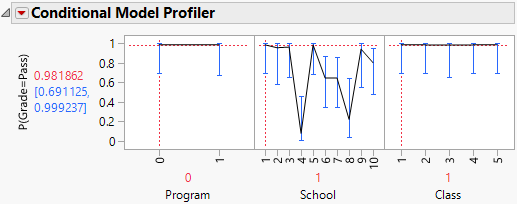

10. Click the red triangle next to Binomial and select Conditional Model Inference > Conditional Profiler.
You can use the Conditional Model Profiler to explore the differences in pass rates for various classes and schools.
Figure 9.5 Conditional Model Profiler
