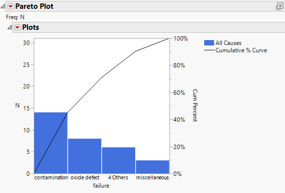

Figure 15.7 Pareto Plot with a Threshold Count of 2
Figure 15.7 displays the plot after specifying a count of 2. All causes with counts 2 or fewer are combined into the bar labeled 4 Others.

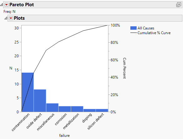

8. To separate the combined bars into original categories as shown in Figure 15.8, select the bar labeled 4 Others.
9. Click the Plots red triangle and select Selected Causes > Separate Causes.

Figure 15.8 Pareto Plot with Separated Causes
