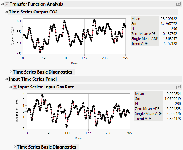

Since an input variable was specified in the launch window, a Transfer Function Analysis report is shown instead of a Time Series Analysis report. The initial report contains a section for the output series and a section for the input series. Each section provides a graphical representation of the series and basic diagnostics.

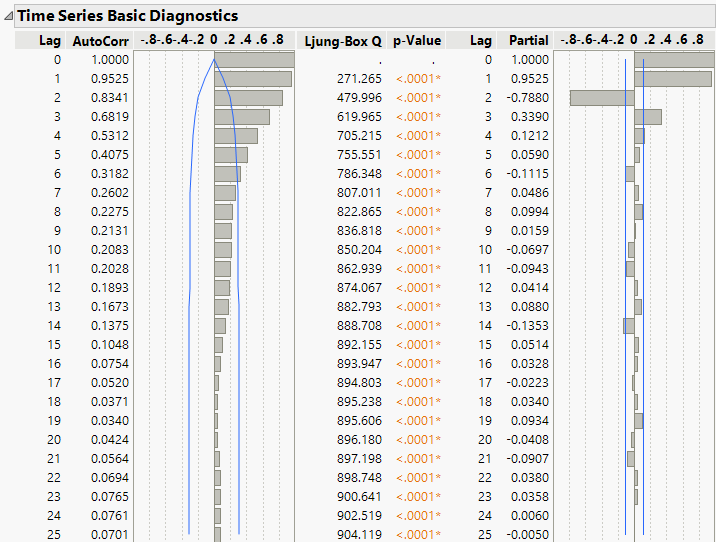

6. In the Input Time Series Panel section, click the triangle next to Time Series Basic Diagnostics.
Figure 18.28 Diagnostics for Input Gas Rate
The Time Series Basic Diagnostics report shows autocorrelations and partial autocorrelations for the input series. There are no cyclical patterns in the correlations that would indicate a significant seasonal trend in the data. Therefore, you do not need to consider seasonal parameters when specifying your transfer model.

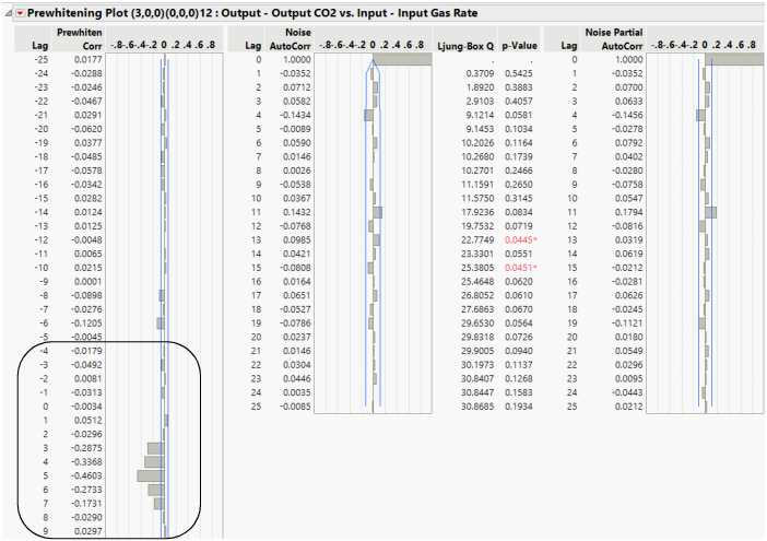

Use the prewhitening results to help identify the transfer function. The outlined portion in Figure 18.29 is the graphical representation of the transfer function. For those less familiar with transfer functions, there is a table in Box et al. (1994) that illustrates what transfer functions look like based on different specifications. According to this table, the pattern of the transfer function corresponds to orders 1 or 2 for both the numerator, ω(B), and denominator, δ(B). See Statistical Details for Transfer Functions for the mathematical specifications of the transfer function. For this example, m = 1, which indicates that there is only one pair of ω(B) and δ(B).
In addition, the first significant nonzero cross-correlation is at Lag 3. The next steps of this example assume an order of 2 for both the numerator and denominator of the transfer function and 3 for the lag, and then fit a preliminary transfer function model.

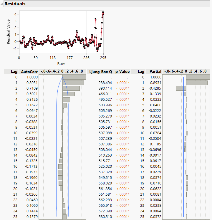

4. Click the triangle next to the Residuals section of the Transfer Function Model (1) report.
Figure 18.30 Residuals for the Preliminary Transfer Function Model
The residuals plot shows that the residuals increase towards the end of the series. Also, there are significant autocorrelations and partial autocorrelations. This indicates that the preliminary transfer function model has not addressed the autocorrelation among the residuals. To better fit the data, the noise series needs to be modeled appropriately. We can look at the partial autocorrelations and see that there is a cutoff of significant correlations at Lag 2. This indicates that perhaps an AR(2) model is appropriate for the noise series.

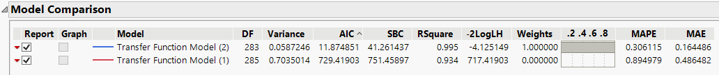

Figure 18.31 Transfer Function Analysis Model Comparison Report
The Model Comparison report indicates that the second transfer function model is a better fit. The second model has a lower AIC and a higher RSquare than the first model.

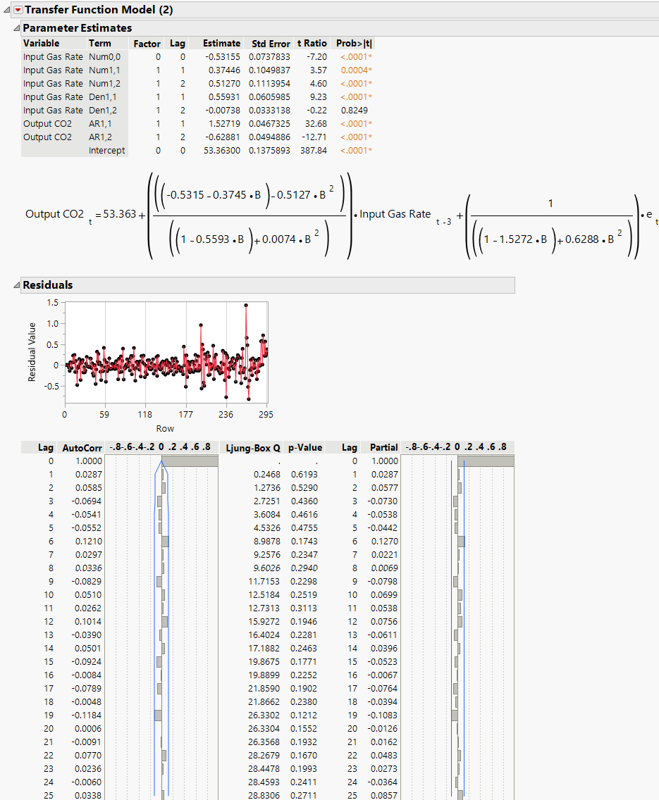

8. Scroll to the report for Transfer Function Model (2).
Figure 18.32 Final Transfer Function Model Report
There is no longer autocorrelation among the residuals, which indicates that this transfer function model is an appropriate model. The model equation is displayed in the report.
