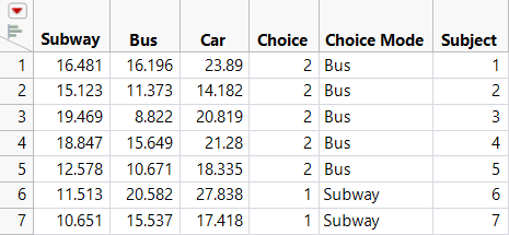

The new Choice Mode column appears in the data table. Because each row contains a choice made by each subject, another column containing a sequence of numbers should be created to identify the subjects.
9. Select Cols > New Columns.
10. Specify the Column Name as Subject.
11. Click Missing/Empty next to Initialize Data and select Sequence Data.
12. Click OK.
Figure 4.45 Partial Daganzo Trip Data with New Choice Mode and Subject Columns

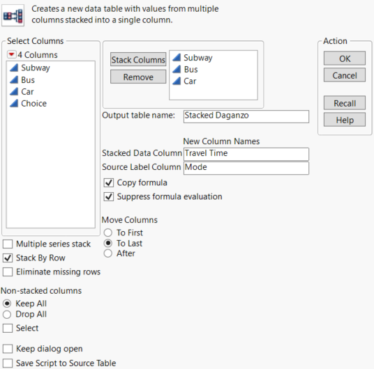

Stack the Data
In order to construct the Profile data, each alternative needs to be expressed in a separate row.
1. Select Tables > Stack.
2. Select Subway, Bus, and Car and click Stack Columns.
3. For the Output table name, type Stacked Daganzo. Type Travel Time for the Stacked Data Column and Mode for the Source Label Column.
Figure 4.46 Stack Dialog for Daganzo Data
4. Click OK.

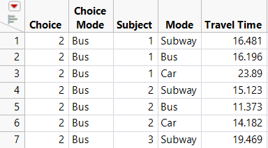

Make the Profile Data Table
For the Profile Data Table, you need the Subject, Mode, and Travel Time columns.
1. Select the Subject, Mode, and Travel Time columns and select Tables > Subset.
2. Select All Rows and Selected Columns and click OK.
A partial data table is shown in Figure 4.48. Note the default table name is Subset of Stacked Daganzo.
Figure 4.48 Partial Subset Table of Stacked Daganzo Data

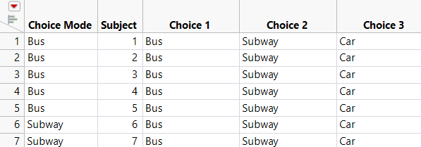

Make the Response Data Table
For the Response Data Table, you need the Subject and Choice Mode columns, but you also need a column for each possible choice.
3. From the Daganzo Trip.jmp data, select the Subject and Choice Mode columns.
4. Select Tables > Subset.
5. Select All Rows and Selected Columns and click OK.
Note that the default table name is Subset of Daganzo Trip.
6. Select Cols > New Columns.
7. For the Column prefix, type Choice.
8. Select Data Type>Character.
9. Enter 3 for the Number of columns to add.
10. Click OK.
The columns Choice 1, Choice 2, and Choice 3 have been added.
11. Type “Bus” (without quotation marks) in the first row of Choice 1. Right-click the cell and select Fill > Fill to end of table.
12. Type “Subway” (without quotation marks) in the first row of Choice 2. Right-click the cell and select Fill > Fill to end of table.
13. Type “Car” (without quotation marks) in the first row of Choice 3. Right-click the cell and select Fill > Fill to end of table.
Figure 4.49 Partial Subset Table of Daganzo Data with Choice Set

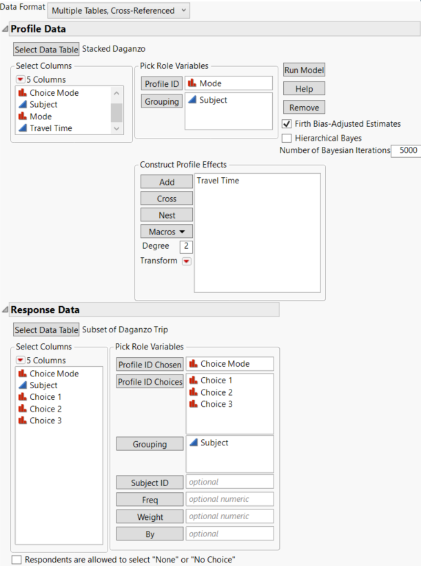

Now that you have separated the original Daganzo Trip.jmp table into two separate tables, you can run the Choice Platform.
1. Select Analyze > Consumer Research > Choice.
2. From the Data Format list, select Multiple Tables, Cross-Referenced.
3. Specify the model, as shown in Figure 4.50.
Figure 4.50 Choice Dialog Box for Daganzo Data with Multiple Tables
4. Click Run Model.

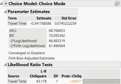

The resulting parameter estimate now expresses the utility coefficient for Travel Time.
Figure 4.51 Parameter Estimate for Travel Time of Daganzo Data
The negative coefficient implies that increased travel time has a negative effect on consumer utility or satisfaction. The likelihood ratio test result indicates that the Choice model with the effect of Travel Time is significant.
