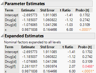

In the Fit Least Squares report, use the Expanded Estimates option when there are nominal terms in the model and you want to see details for the full set of estimates. The Expanded Estimates option provides the estimates, their standard errors, t ratios, and p-values.

Figure 3.21 Comparison of Parameter Estimates and Expanded Estimates
The Expanded Estimates report, along with the Parameter Estimates report, is shown in Figure 3.21. Note that an estimate for the term Drug[f] appears in the Expanded Estimates report. The null hypothesis for the test is that the mean for the Drug f group does not differ from the overall mean. The test for Drug[f] is significant at the 0.05 level, suggesting that the mean response for the Drug f group differs from the overall response. See Interpretation of Tests for Expanded Estimates.

In the Drug.jmp report shown in Figure 3.21, the estimates for the terms associated with Drug are based on a model that includes the covariate x.
Notes:
• The estimate for Drug[a] is the difference between the least squares mean for Drug a and the overall mean of y.
• The estimate for Drug[f], given in the Expanded Estimates report, is the negative of the sum of the estimates for Drug[a] and Drug[d].
• The t test for Drug [f] presented in the Expanded Estimates report tests whether the response for the Drug f group differs from the overall mean response.
