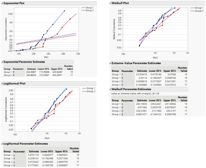

For each of the three supported distributions in the Survival platform, there is a plot command and a fit command. Use the plot command to see whether the event markers seem to follow a straight line. The markers tend to follow a straight line when the distributional fit is suitable for the data. Then, use the fit commands to estimate the parameters.
Figure 14.5 Exponential, Weibull, and Lognormal Plots and Reports

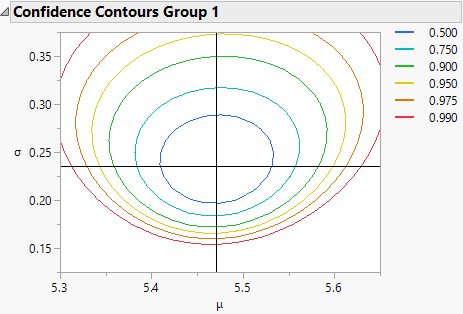

• Obtain a Confidence Contour Plot for the Weibull and lognormal fits (when there are no constrained values).
Figure 14.6 Confidence Contour Plot
