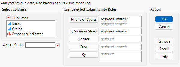

Launch the Fatigue Model platform by selecting Analyze > Reliability and Survival > Fatigue Model.
Figure 6.4 The Fatigue Model Launch Window
The Fatigue Model launch window contains the following options:
N, Life or Cycles
Identifies the column that contains the lifetime variable (N). When your response values are interval-censored, you can enter two columns. See Specify Two Y Columns.
S, Strain or Stress
Identifies the column that contains the strain or stress variable (S).
Censor
Identifies a column that designates if a response measurement is censored.
Freq
Identifies a column that contains a frequency for each row.
By
Identifies a variable to produce an analysis for each level of the By variable.
Censor Code
Specifies the value in the Censor column that designates censored observations. After a Censor column is selected, JMP attempts to automatically detect the censor code and display it in the box. To change this, click the red triangle and select from a list of values. You can also enter a different value in the box. If the Censor column contains a Value Labels column property, the value labels appear in the list of values. Missing values are excluded from the analysis.
