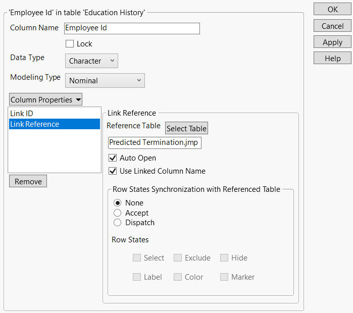

• You can also increase portability by using a JMP path variable in the Link Reference path. Figure 5.10 shows an example. Enter a forward slash in the path to share the data tables with both Windows and macOS users. See “Path Variables” in the Scripting Guide for more information about path variables.

• You can specify that the linked column name be used in virtually joined columns. This option lets you specify a shorter column name (for example, Cheese instead of Cheese[Choice]). In the Link Reference column property, select Use Linked Column Name.
Figure 5.10 Link Reference Column Property Definition
