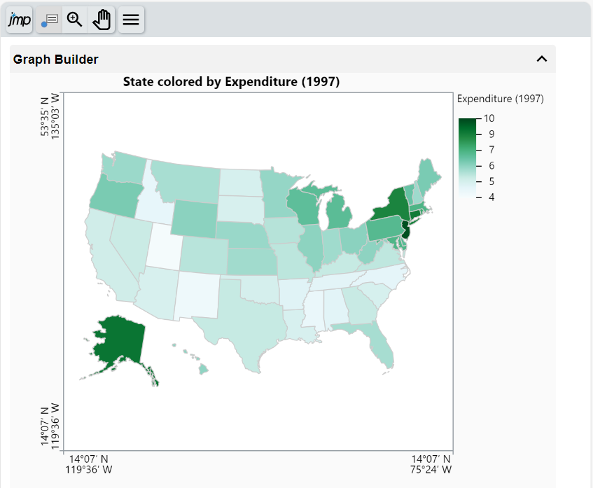

The output is saved in the selected folder and opens in a browser.
Figure 11.2 Web Page for Single Interactive HTML Report

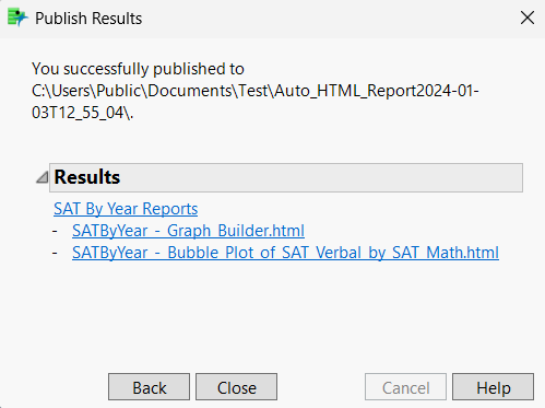

8. Click Publish.
Figure 11.3 Index Page for Multiple Interactive HTML Reports
9. Click a report title to open a report.
