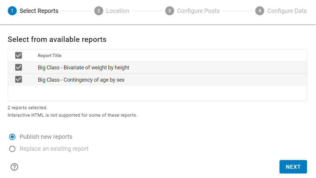

3. Select the reports that you want to publish.
Tip: To choose all open reports, select the Report Title box. If you are replacing a report, you must choose only one report.
4. Choose what you want to do:
– Publish New Reports
– Replace an Existing Report
5. Click Next.

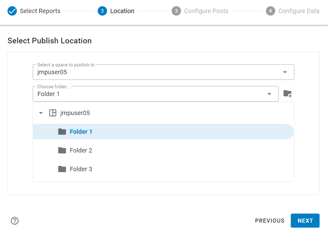

Publish New Reports
Figure 11.5 Select Where to Publish the Reports
1. Choose the space where you want to publish your report. To find a space, enter the space name.
Note: You see only spaces that you have permission to publish to.
2. Select an existing folder from the list or enter text to find the folder where you want to publish your report.
Note: You see only folders that you have permission to publish to.
Tip: To create a new folder, click the space or folder where you want to create the folder and click Create folder Image shown here.
3. Click Next.

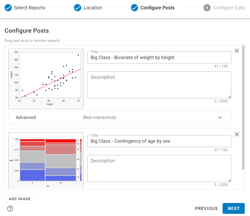

Figure 11.6 Update Report Options
4. (Optional) You can:
– Update the title for each report.
– Click and drag to move the report order.
– Add a description, image, or set advanced options. See Report Options.
5. Click Next.

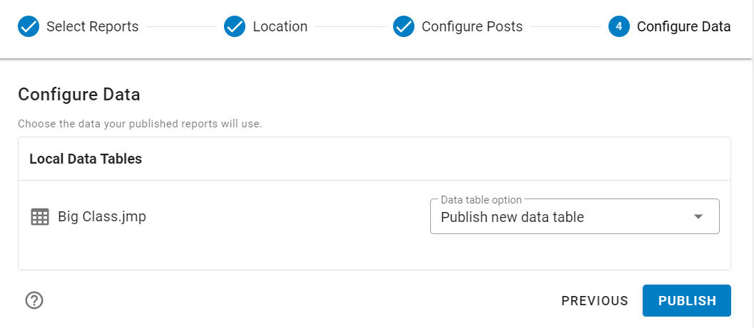

Figure 11.7 Update Data Options and Publish
6. Choose whether to publish a new data table or use or update an existing JMP Live/Public data table. JMP populates this option based on what is currently in the space that you are publishing to.
– If an exact copy of your local data table exists, the option is set to use that data table.
– If you have made changes to a data table that exists, the option is set to update the existing table. Any other reports that use this data table also update to use the new data.
Notes:
– In order to use existing data, you must have permission to download the data.
– If a refresh or import script is set on the existing data in JMP Live, the only option is to use the existing table, since you cannot manually update these tables.

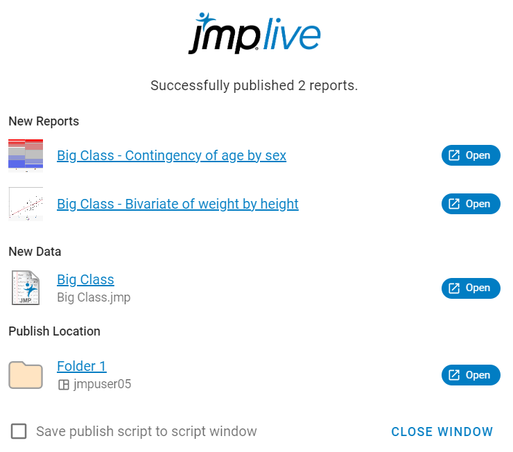

7. Click Publish.
Figure 11.8 Publish Status for Creating a New Report
8. (Optional, JMP Live only) To save your process as a JSL script, select Save publish script to script window.
9. Click an Open link to launch JMP Live, or click Close Window.
Figure 11.9 Published Reports in a JMP Live Folder
Note: Who can see your post depends on space and folder permissions. For details, see the JMP Live Help. In JMP Live, click Image shown here > Help.

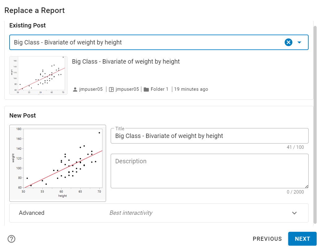

Figure 11.10 Select an Existing Post
Note: You see only posts that you have permission to update.
1. Select an existing post from the list or enter text to find a post.
2. Click Next.

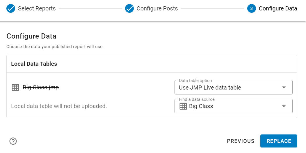

Figure 11.11 Choose How to Publish Data
3. Choose whether to publish a new data table or use or update an existing JMP Live/Public data table. JMP populates this option based on what is currently in the space that you are publishing to.
Notes:

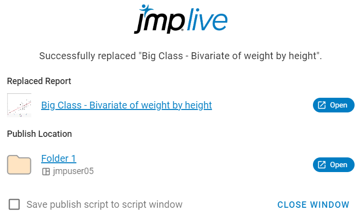

4. Click Replace.
Figure 11.12 Publish Status for Replacing a Post
5. (Optional, JMP Live only) To save your process as a JSL script, select Save publish script to script window.
6. Click an Open link to launch JMP Live, or click Close Window.

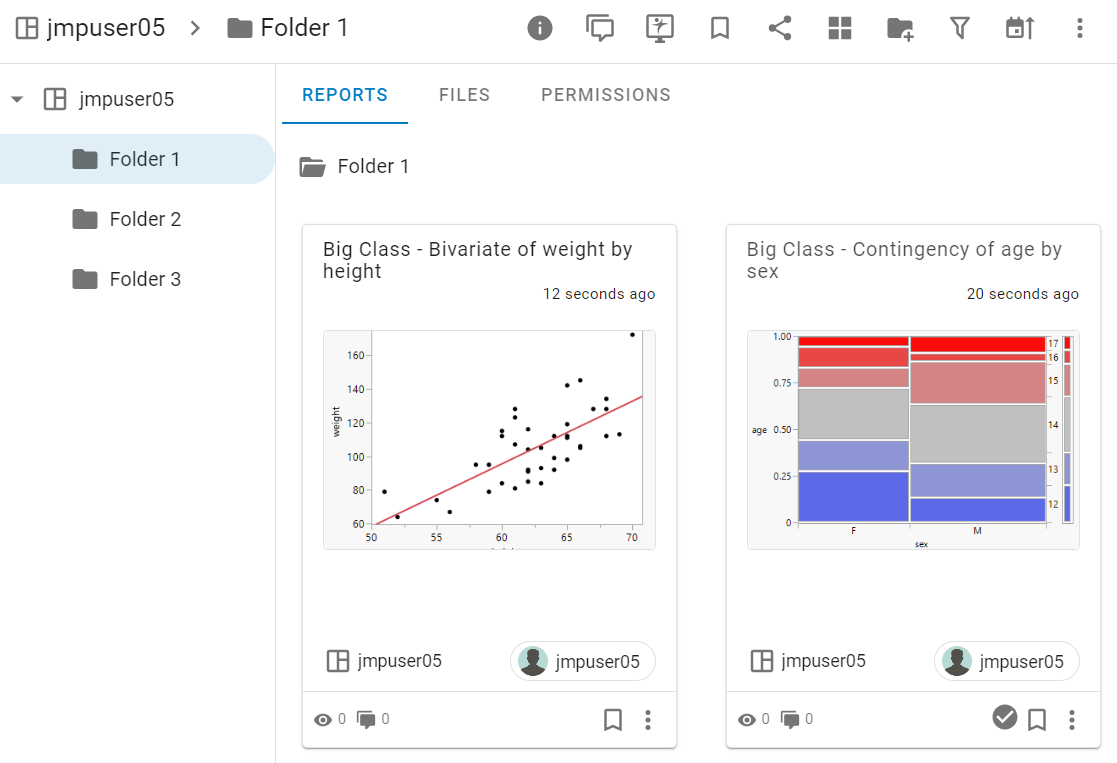

Figure 11.13 Published Reports in a JMP Live Folder
