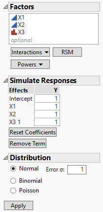

Figure 8.10 shows the Model window for a design with two continuous factors (X1 and X2) and one two-level categorical factor (X3).
Figure 8.10 Simulate Responses Control Window
The window has three sections:
• Factors
• Simulate Responses
• Distribution
