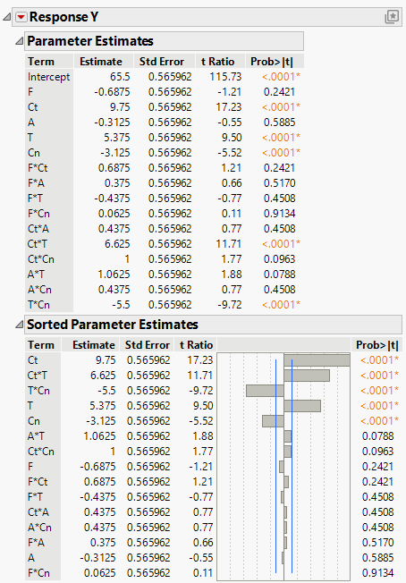

In the Fit Least Squares report, the Sorted Estimates option produces a version of the Parameter Estimates report that is useful in screening situations. If the design is not saturated, the Sorted Estimates report gives the information found in the Parameter Estimates report, but with the terms, other than the Intercept, sorted in decreasing order of significance (second report in Figure 3.19). If the design is saturated, then Pseudo t tests are provided. These are based on Lenth’s pseudo standard error (Lenth 1989). See Lenth’s PSE.
Figure 3.19 Sorted Parameter Estimates
The Sorted Parameter Estimates report also appears automatically if the Emphasis is set to Effect Screening and all of the effects have only one parameter.
Note the following differences between the Parameter Estimates report and the Sorted Parameter Estimates report (both shown in Figure 3.19):
• The Sorted Parameter Estimates report does not show the intercept.
• The effects are sorted by the absolute value of the t ratio, showing the most significant effects at the top.
• A bar chart shows the t ratio with vertical lines showing critical values for the 0.05 significance level.

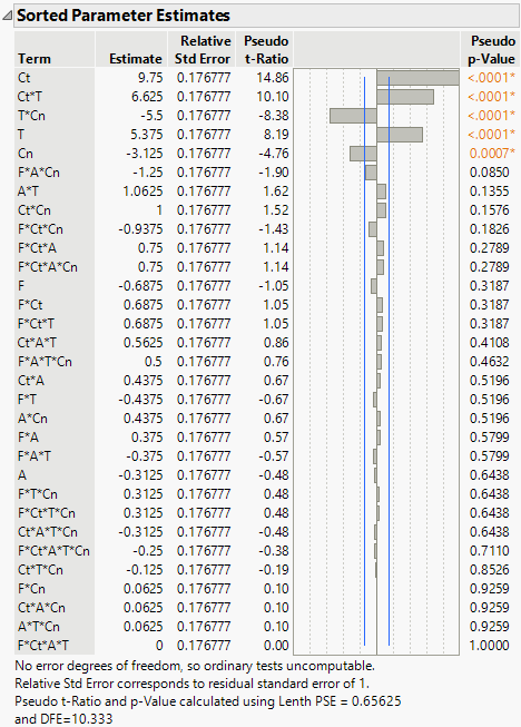

Sorted Estimates Report for Saturated Models
Screening experiments often involve fully saturated models, where there are not enough degrees of freedom to estimate error. In these cases, the Sorted Estimates report (Figure 3.19) gives relative standard errors and constructs t ratios and p-values using Lenth’s pseudo standard error (PSE). These quantities are labeled with Pseudo in their names. See Lenth’s PSE and Pseudo t-Ratios. A note explains the change and shows the PSE.

Figure 3.20 Sorted Parameter Estimates Report for Saturated Model
Note that Lenth’s PSE and the degrees of freedom used are given at the bottom of the report. The report in Figure 3.20 indicates that, based on their Pseudo p-Values, the effects Ct, Ct*T, T*Cn, T, and Cn are highly significant.
