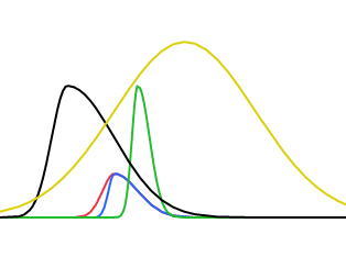

ExGaussian Peak (Exponentially Modified Gaussian Peak)
Image shown here
Equation shown here
a = AUC (area under the curve)
b = Location
c = Scale
d = Lambda
φ = the standard normal pdf

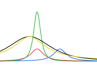

Pseudo-Voigt Peak
Image shown here
Equation shown here
d = Mixing Parameter
l(x) = evaluation of Lorentzian Peak function
g(x) = evaluation of Gaussian Peak function
Available only when the response values are nonnegative.

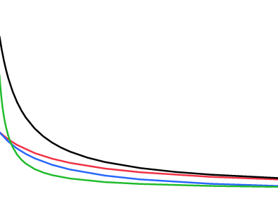

Antoine Equation
Image shown here
Equation shown here
a = Component Specific Constant
b = Component Specific Constant
c = Component Specific Constant
Available only when the response values are greater than 0.
The vertical asymptote is at 10a.
The horizontal asymptote is at −c.

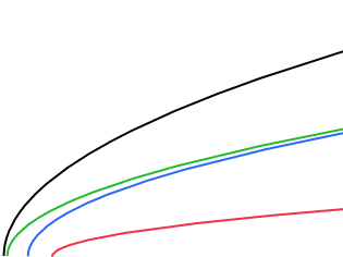

Higuchi with Lag
Image shown here
Equation shown here
a = Release Constant
b = Time Lag
Available only if all x and y values are nonnegative.

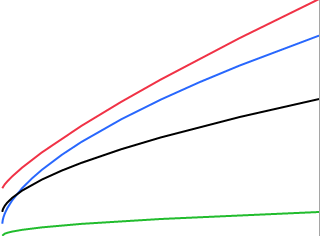

Higuchi with Burst
Image shown here
Equation shown here
b = Burst
