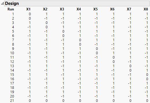

Figure 8.21 shows an example of a definitive design with eight continuous factors and four Extra Runs that correspond to fake factors. Notice the following:
• Each pair of rows is a foldover pair; each even-numbered row is -1 times the previous row. The foldover aspect of the design removes the confounding of two-factor interactions and main effects.
• Each factor is set at its center value for three runs; this, together with the design’s construction, makes all quadratic effects estimable.
• Rows 17 through 20 are the Extra Runs that correspond to the fake factors.
• Adding the center run in the last row enables you to fit a model that includes an intercept and all main and quadratic effects.
This structure is typical of definitive screening designs for continuous factors.
Figure 8.21 Definitive Screening Design for Eight Continuous Factors
